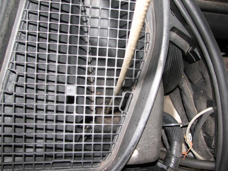

The other possibilities are water Damage. Have you checked the black plastic redervoir under the passenger side windshield?
If there is any water in there your drain is clogged and your elevtronics are damaged , if you have comprehensive auto insurance they should cover water damage

yea i've made sure the revs since is clear always since i bought the car last year and looked at it while it still belonged to the other owner. No reason to suspect it ever overflowed. But maybe its worth pulling up passenger floor carpet to see if it EVER had? I believe thats where you look right?
