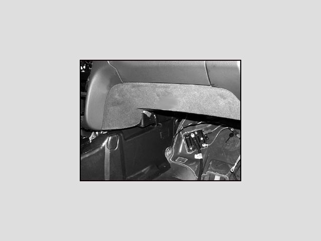

You likely have a bad fuse located in terminal block X4/10. It is located in the passenger footwell of a LHD car (picture). The "diagnostics" you will need is a simple multimeter, test light, or other means for detecting 12VDC or measuring electrical continuity.
