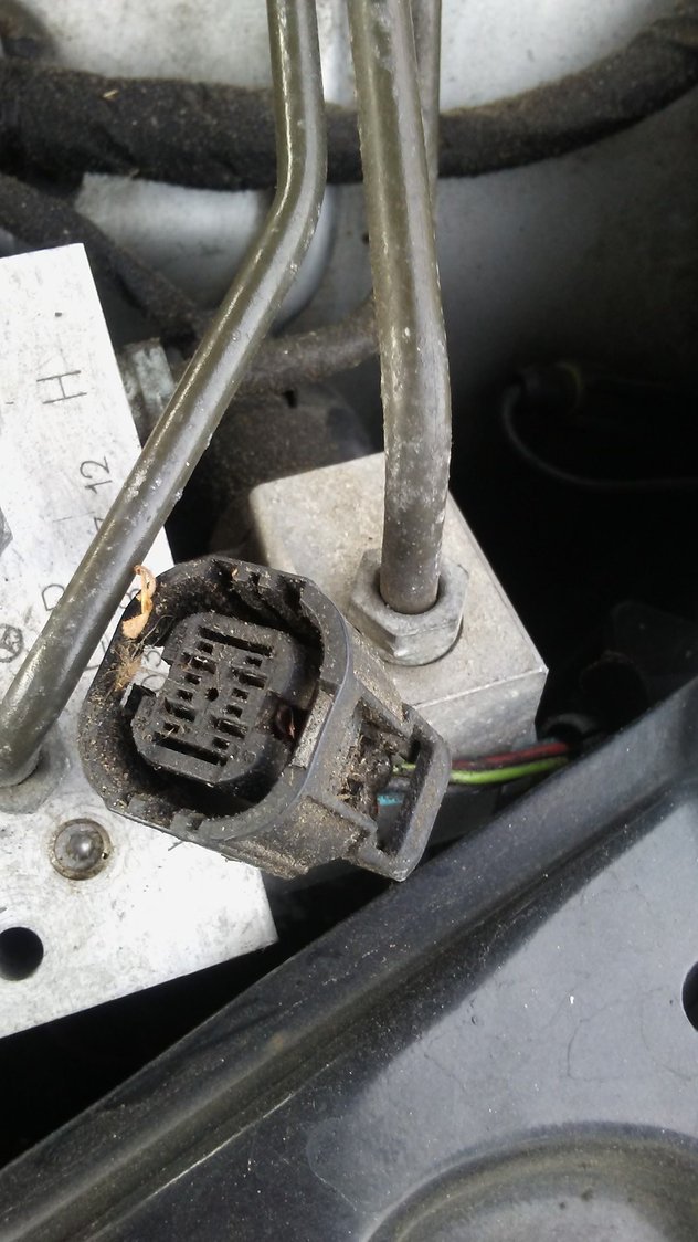

Side bar: Can anyone tell me what these plugs are and where they are supposed to connect to. I assumed the abc system as the suspension has been converted, but the bilateral ones coming off the engine block dont make much sense to be part of the disconnected abc system One on both sides. Coming off engine block
One on both sides, near strut housing. Probable ABC?
