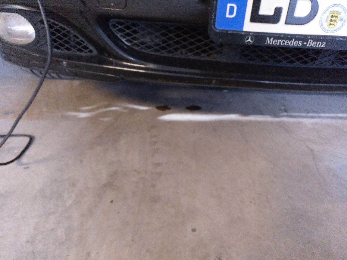

The saga continues. I swapped in a new thermostat tonight. Now it holds temp perfectly.
But... After allowing it to heat up and evidence the ability to hold temps now, I found a new leak that I had not seen before. Now it is below the thermostat at the front of the engine. My guess is that the water pump is down in there somewhere. Could there be any other source of a coolant leak amongst the pulleys?
If you look at this picture, the leak is a steady stream that looks like a string next to the second belt.
Now I have to wonder what a water pump costs. Tempted to get a quote for the work too, since I have other car projects I want to wrap before it gets too cold.

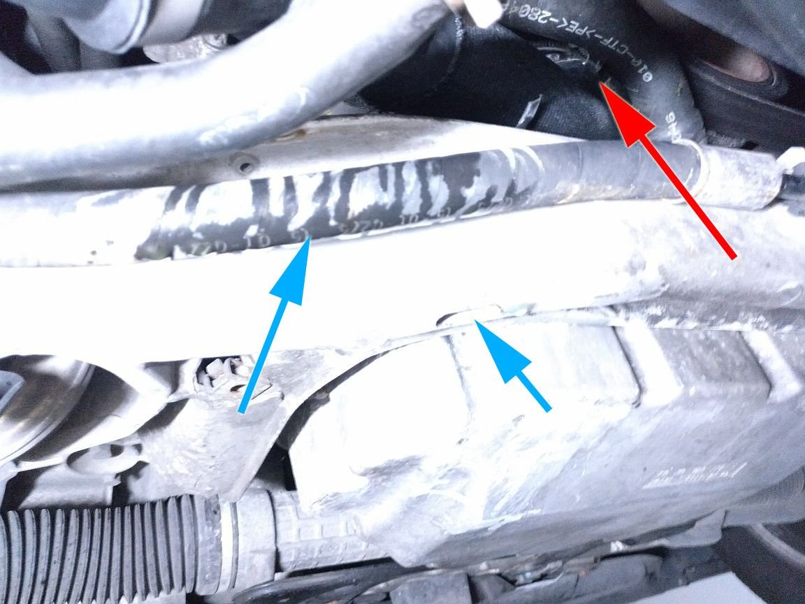

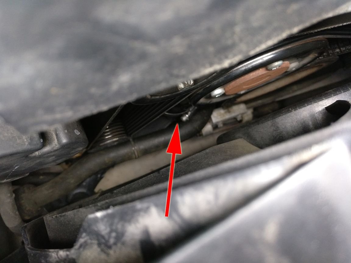

Hi, I might have the same problem as you. I think I identified my leaking spot as the lower coolant hose where it connects to the water pump just beneath the water pump pulley. I'm quite certain that that is also your issue.
When under the car, looking between the subframe and the oil pan, you can see the top of the lower coolant hose. It is a huge pain to get the hose to fit there properly. I tried twice and still didn't succeed.
I took some pictures as well but couldn't take a good one:
Red arrow points to the suspected end of the lower coolant hose connecting to the water pump.
Blue arrows show from where the coolant drips down.
View from the front w/o underbody panels.
As said before, I tried to fix it twice and couldn't do it. The main problem seems to be the engine facing part of the hose which is hardly reached. I have a hard time pushing the hose up the whole way.
It also might drip down from the water pump above it. Didn't see proof for that yet, though.
Note: My car has the M137 V12 engine (CL 600 '02)
Any suggestions?
