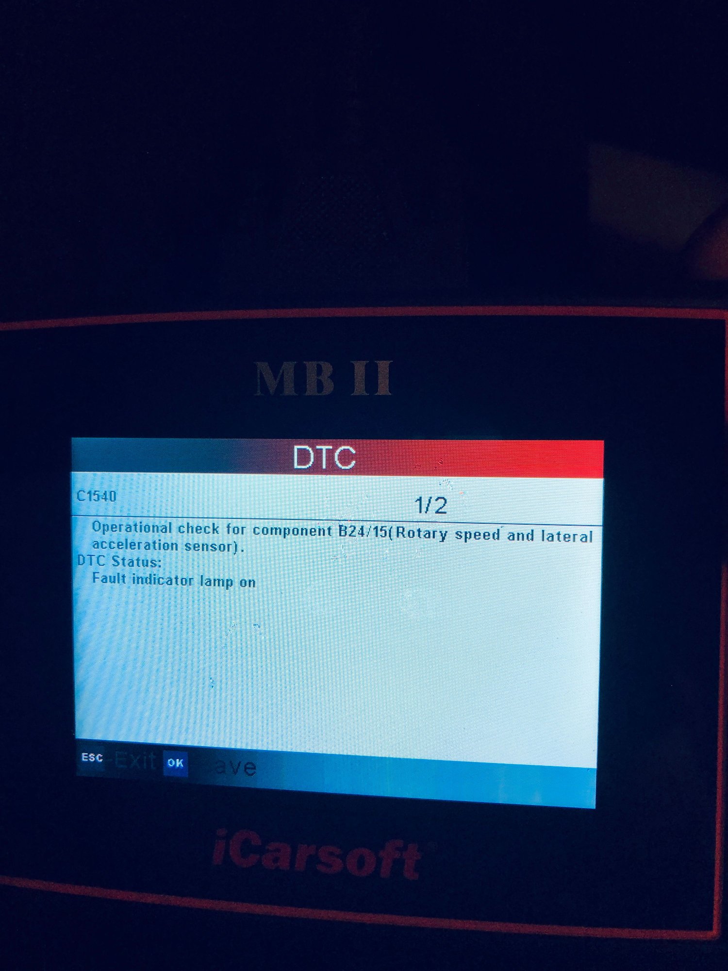

So I was messing with my mbII icarsoft trying to fig out my suspension problems.after doing a driving test now my abs light turned on and I got a code.
wondering if this has happened to anybody else or is just my luck it messed up

Tried it but not nothing.i think it has to do with the driver test that supposed to be performed by a certified person and me messing with it caused the code

Ok try this. Go to suspension in the mb II and read the codes. Try and clear those as well. Make sure they get cleared. Make sure and check all connections in the fender wells where the abs sensors connect. I had an issue with the abs light on which caused the esp, and bas light to come on as well. I read codes and it told me it was the level sensor and the acceleration sensor. Making sure the abs plug was pushed in all the way cleared up all of the codes. If you have AirMatic issues they could be related as well. The Airmatic plug and abs plugs connect to each other and plug in to one single port. Also do the steering wheel trick as well. These should work.
