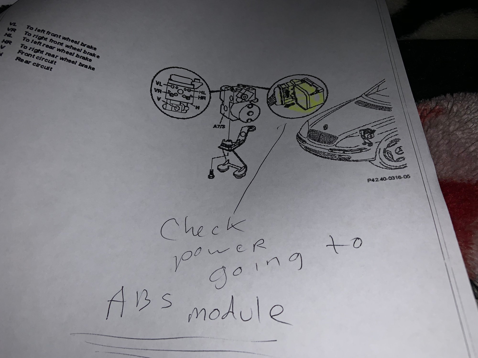

Took car to get diagnosed this is what was printed out. Can I get a used pump with matching numbers? And is it plug and go or does it have to be programmed to my vin? It is my esp module.

remove the electronic side of the module and send it to a reputable business that repairs them, im based in aus and the business i use is logicar.
much more cheaper than a new/2nd hand and doesnt need programming.
just fit repaired unit clear codes, test drive. might need an adaptation of sorts i cant remember (done with obd tool)

You can buy a used module cheap on eBay and swap the electronic part
