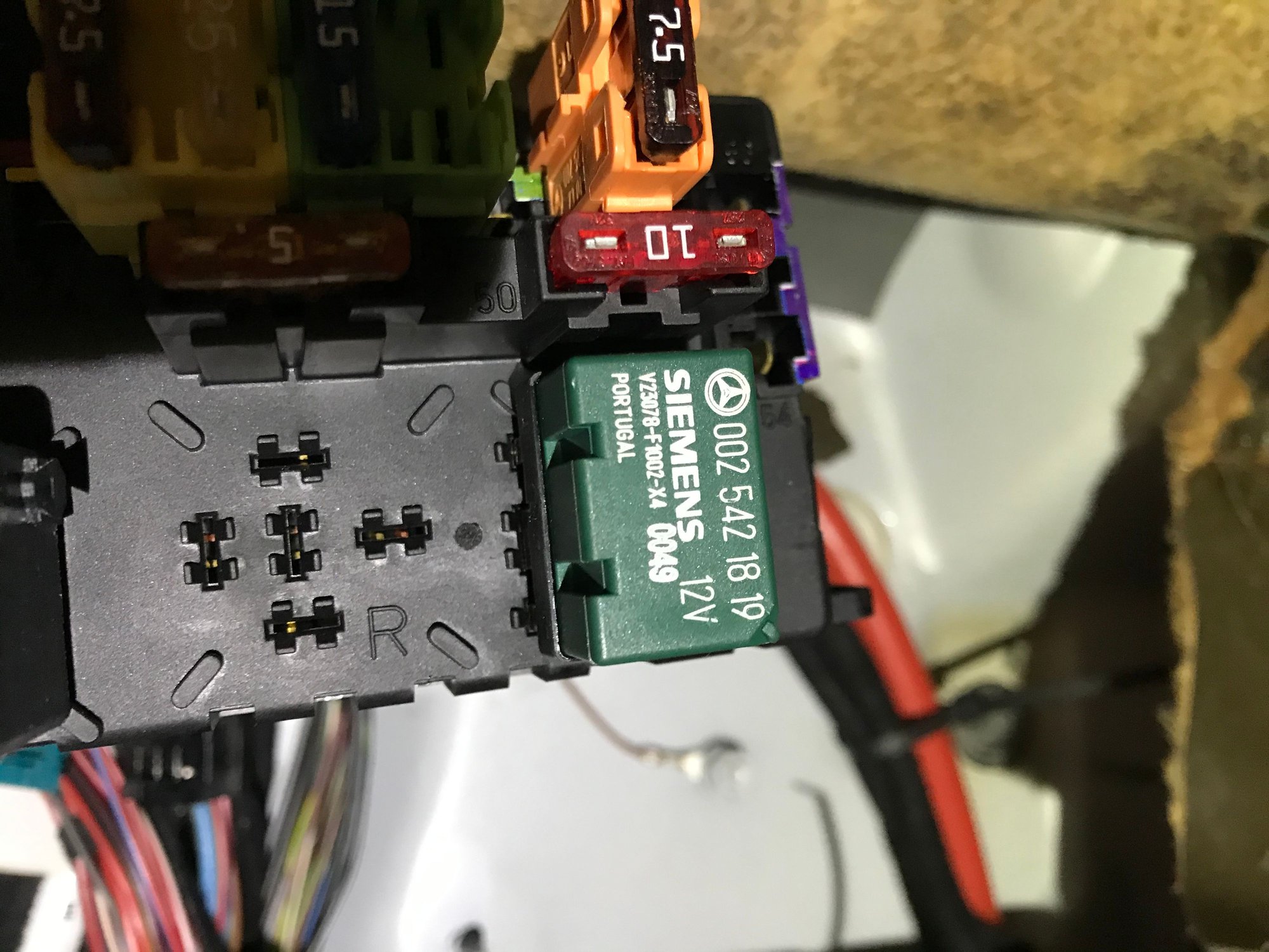

All the sams seem to be in good condition. No corrosion,rost or wetness. Only thing that i saw was relay on rear sam box. There was thing or things loose inside of it.
the green one.
Old Dec 13, 2020 | 10:38 AM

apparently thats the "rear blind"

the rear blind works. tomorrow morning testin all the SAMs with heat gun. we will see if it helps.

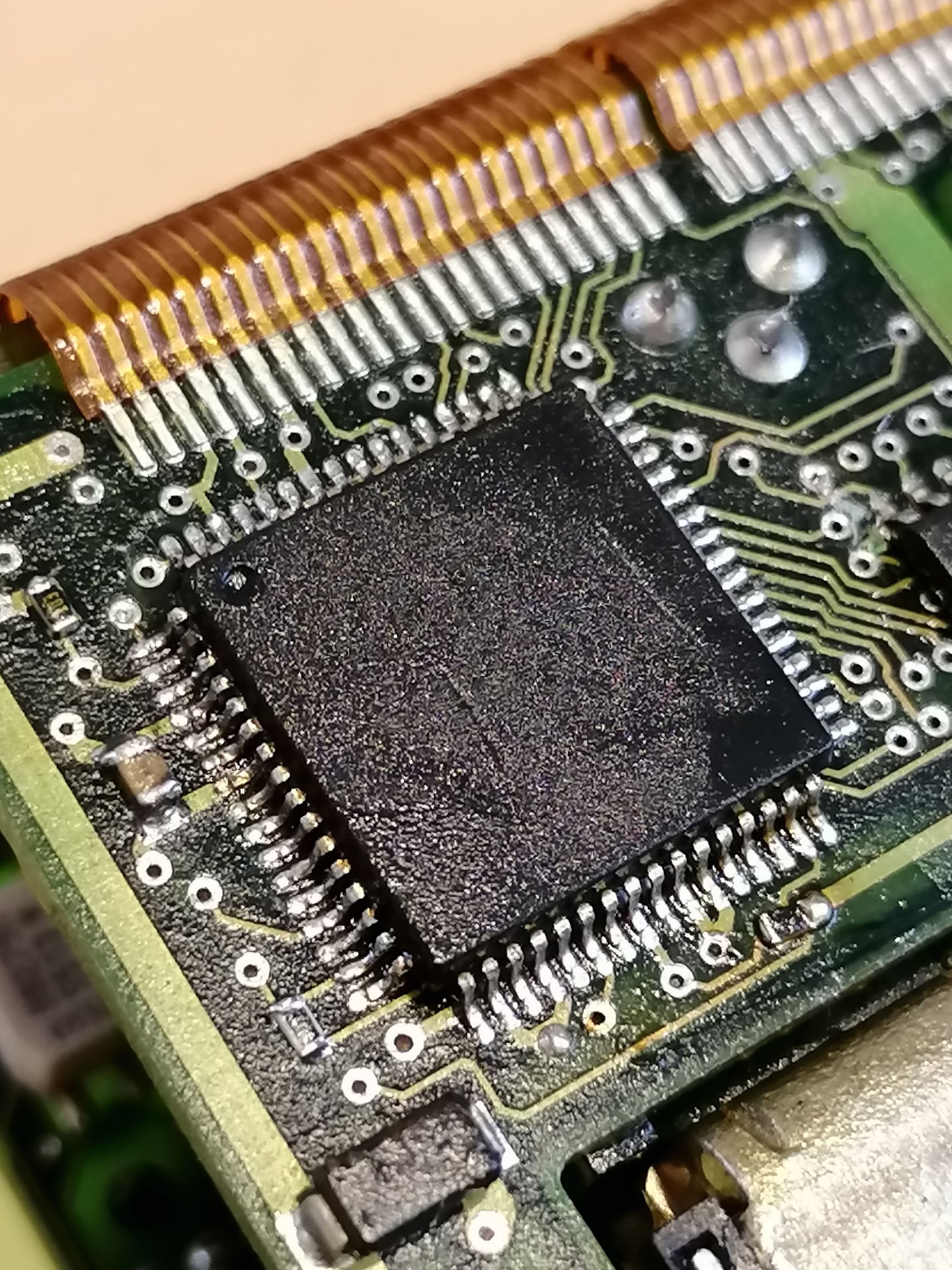

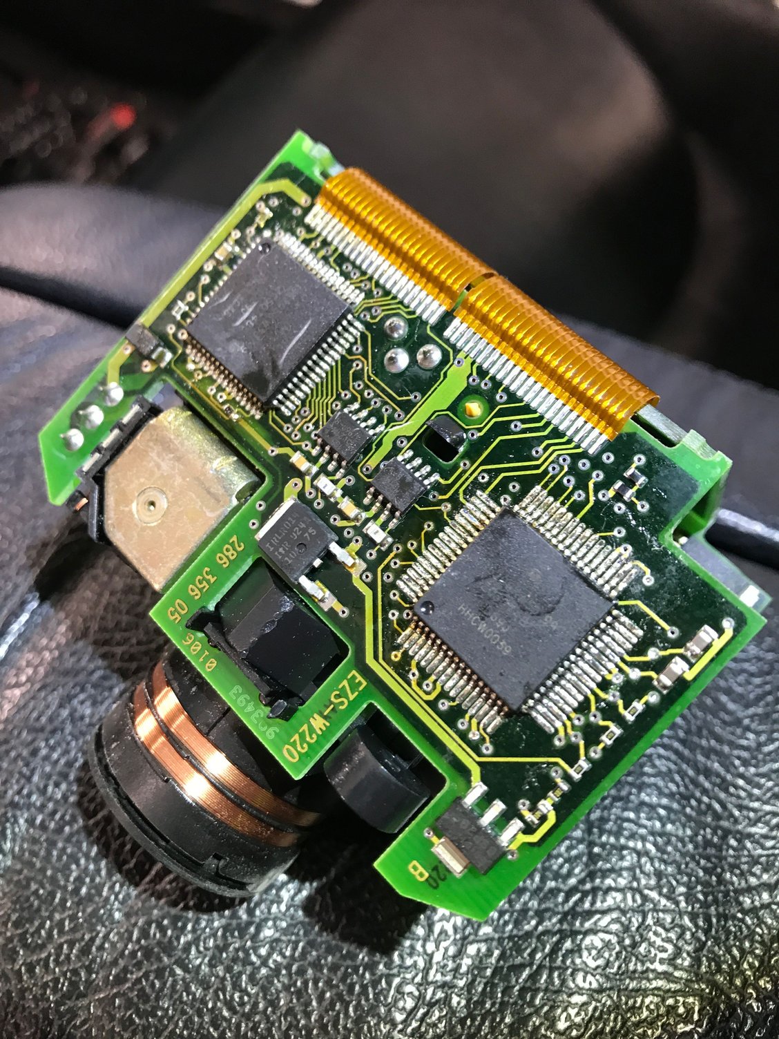

UPDATE. There was something weird stuff in the EIS module if you can see in the picture. Now putting it outside and watching what it does.

Problem is solved!
EIS module is broken. the car didnt work with EIS module wich was frozen. i got it out and putted it in room temperature for a littlebit. when the module was warm i putted it back in the car and the car worked normally.

This microchip is the fault for the whole system. i dont know a lot about these electronic components but is it possible that the joints that connect to the board are bad or is the whole microchip broken. i have a guy who can do this replacement job but i dont know where to find these kind of chips.

It is just the solder joints
take to good Computer repair guy to solder
