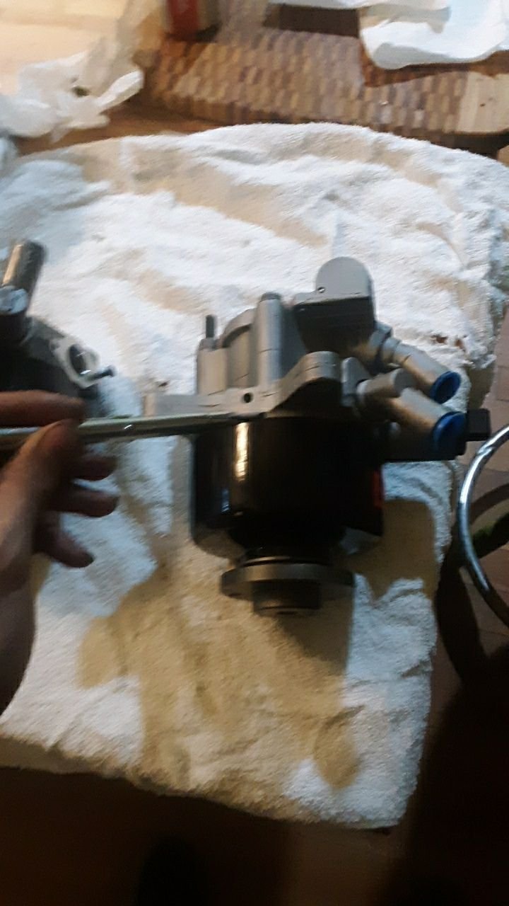

So it appears that I found the leak... It's the actual pump casing on the ABC side. Decided to rebuild it myself, ordered kit, will update afterwards.

Haven't pulled it out of the vehicle yet, doing it this weekend but I ordered a whole new reman unit and pointed to where I could see it leaking from on the vehicle. Also I have another question, the feed for the ABC reservoir on this remanned unit is point in the opposite direction... I don't think that means it'll be impossible to mount but I'll need a different hose as these seem to be press fit in, every part number seems to match. Is this normal? will it work?
