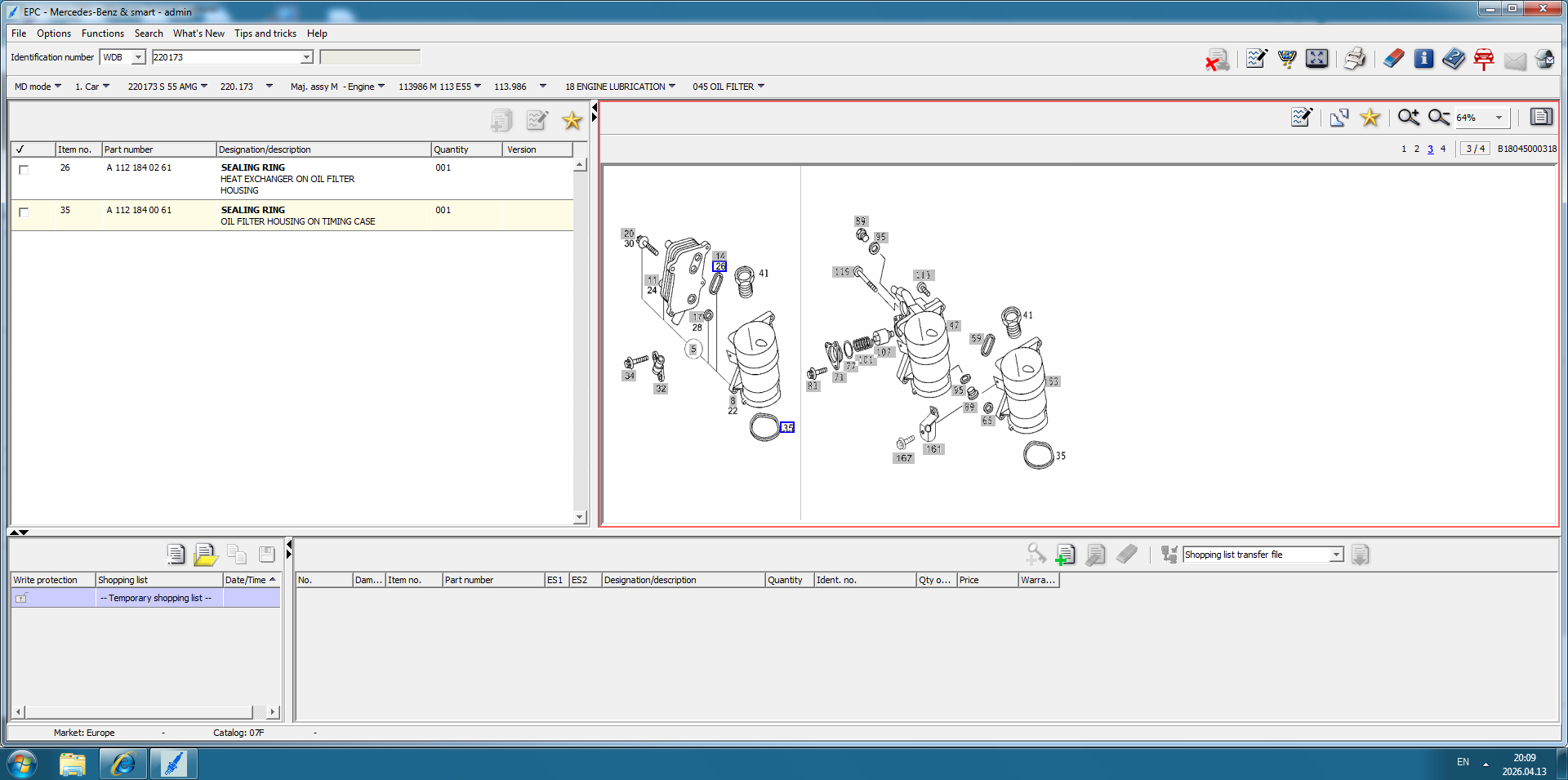

Apr 13, 2026 | 01:12 PM
Hello all,
Looked on EPC, should be this, engine is 113.986
Reply 0
Apr 13, 2026 | 01:18 PM
Thank you very much for looking it up. I think the engine is 113.961. The original post also had a screenshot from epc. Epc seems not to be correct for this version. The difference seems to be between the us and European version. The timing cover housing also have different partnumbers depending on the regional version.
Reply 0
Apr 13, 2026 | 01:26 PM
Quote: Thank you very much for looking it up. I think the engine is 113.961. The original post also had a screenshot from epc. Epc seems not to be correct for this version. The difference seems to be between the us and European version. The timing cover housing also have different partnumbers depending on the regional version.
You can send me your VIN number, so I can check it if you need.
Checked for several engines numbers, part number was same for all
