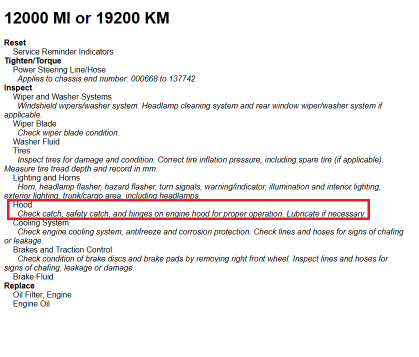

When im in the engine bay working on something I will always check and lubricate the latches. I had a latch break years ago on a previous car so now its just something I always check.
Seems to be on the W220 normal service items. Maintenance > Service intervals > Normal service : https://charm.li/Mercedes%20Benz/200...d%20Diagnosis/

wow, the website you linked is a goldmine
