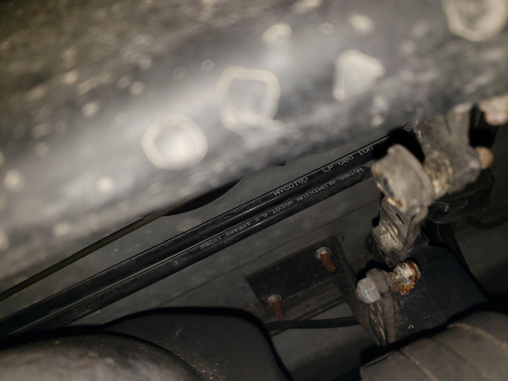

I have a 2000 S500 10/99 build date that i just purchased that has been sitting for 2 years , it does NOT have ABC and is not a 4matic , The struts were deflated , We installed a new battery and it started right up and the air struts inflated , There was NO warnings on the dash , I drove the car for 3 days with No issues, As I was driving home on the 4th day both rear struts lowered them selves all the way down and the fronts were fine , Lucky I was 2 blocks from my home , The compressor was not running during the 2 block ride home nor was it running when I parked it , Using the suspension lift button on the dash the compressor kicks on and I hear NO leaks in the rear struts nor do they go up, currently has a airmatic service on dash. Thank you in advance

First thing to check is the rear ride height sensor, they are known to break

I crawled under the car and sure enough there it was the arm was just hanging , It clearly has seen better days , Ill start looking around tomorrow for a new one , Hopefuly I make past 3 days to another issue puts it back in the driveway
