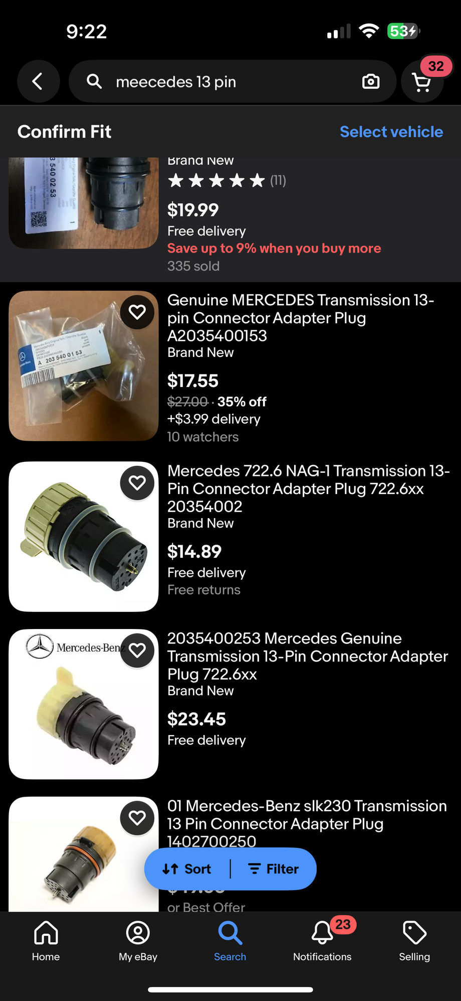

Arrow 13 pin connector, 722.6 vs 722.9
Hi tusabes,
Thanks for the information about the 13 pin connector. I was reading about it and checking the links you sent, and I think the 13 pin connector is for cars with a 722.6 transmission. Since my car has a 722.9 transmission, I think I should be good without this.
