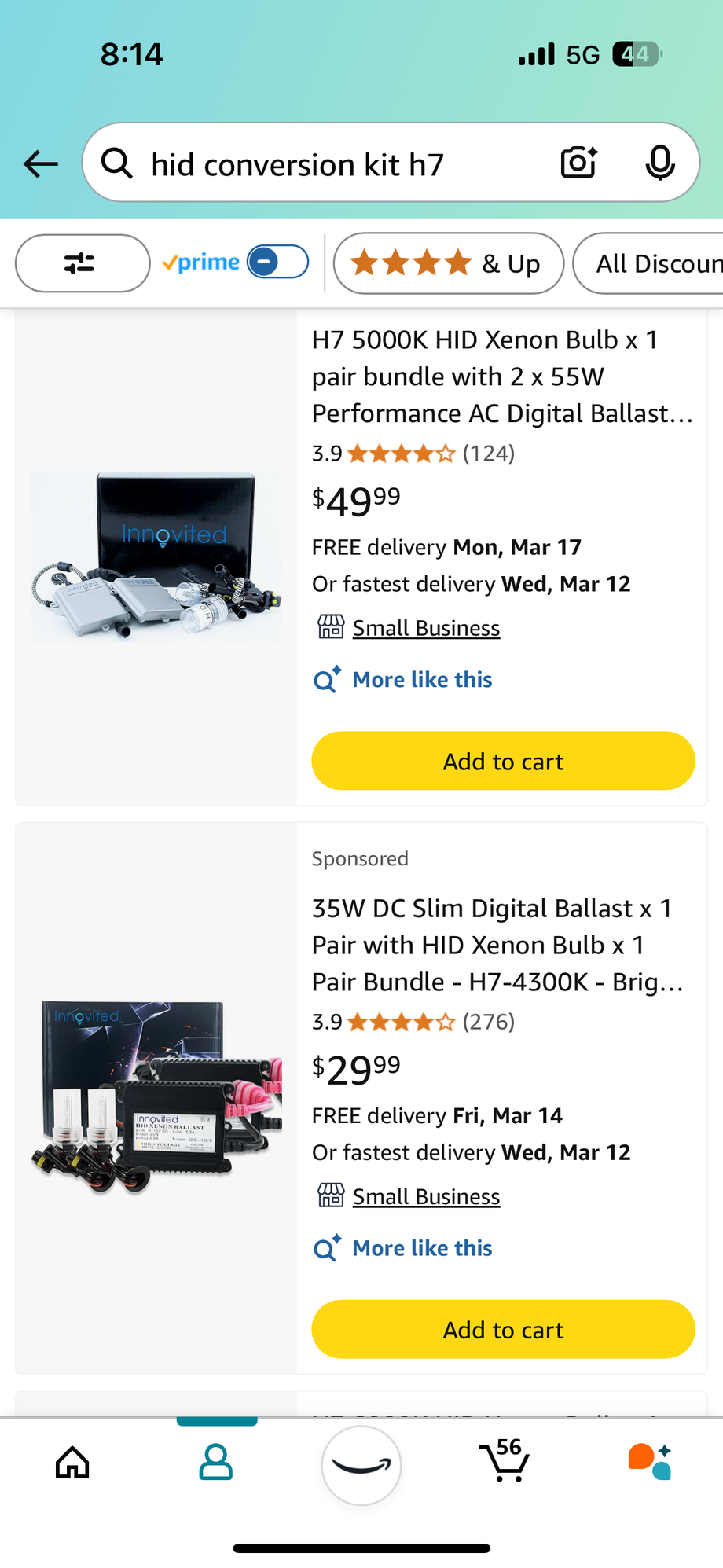

the cheap and quick way is to Get a universal hid conversion light kit from Amazon that includes bulbs ballasts and wiring . They use one plug connected to the factory wires just as a turn on /off signal , but both bulbs are connected with new wiring as part of the conversion kit . Connect that one turn on wire to your working side .

You don’t need to convert to HID, but if you want both headlights to work for the cheapest way possible, that will get both headlights working for the cheapest way possible. Your LED light is garbage and probably the reason it blew out the sam
yes, the proper way is to investigate the headlight circuit in the Sam and fix it properly. Since there are two headlight circuits in each of the Sam’s under the engine compartment, you can swap the relay from the left to the right and see if the failure moves sides. It may just need the relay inside the sam rather than the entire Sam.
the reason I said the cheapest way to get both headlights working isto buy a HID conversion kit is because the conversion kits only require one turnon signal from one headlight, and if you hook it up to the working headlight,then both sides will work, as the kits include wiring that uses the one turn on signal to turn on both hid bulbs and ballast in the kit..

yes, but the aftermarket HID kits only require a turn on signal from one side , in order for both sides of the hid kit to work.
The LED kits require power from both sides to be working.
