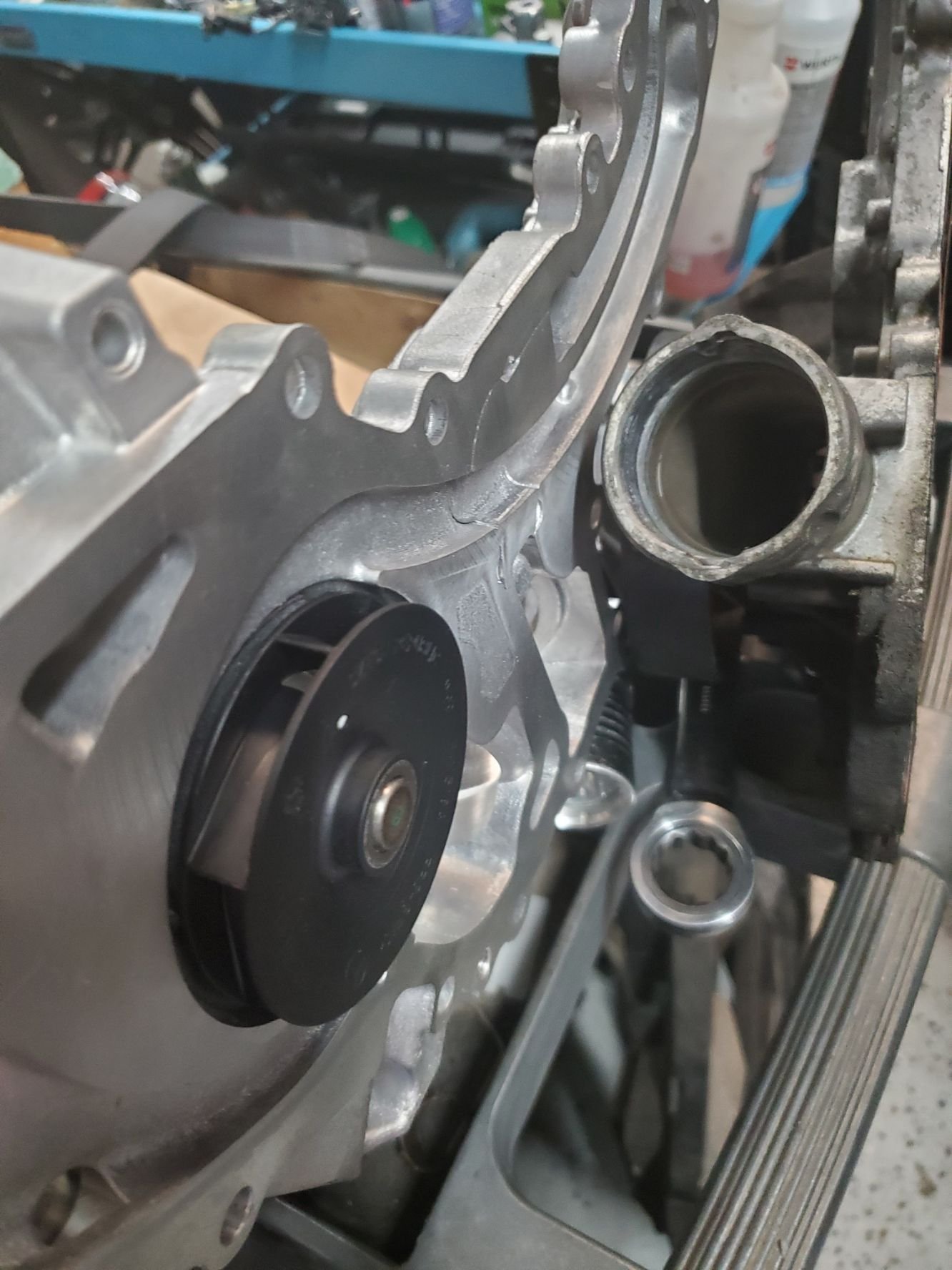

My issue.....the pump wheel had moved on the shaft of the water pump. It moved far inboard of where it is supposed to sit. Seems very odd to me - that was the cause.

was it overheating while driving only ? it's just weird it never went over 85-90 while idling. then driving it, starts ticking upward. it hit 120c.

Went through a few variations. I think while the impeller was moving inboard. The impeller is fully confined by the pump housing - as compared to being fully outbound of the impeller housing. To me, very odd. But, if not driving, temps were normal idle temps.

I think I will give the water pump a shot. the car has 200k miles lol.
