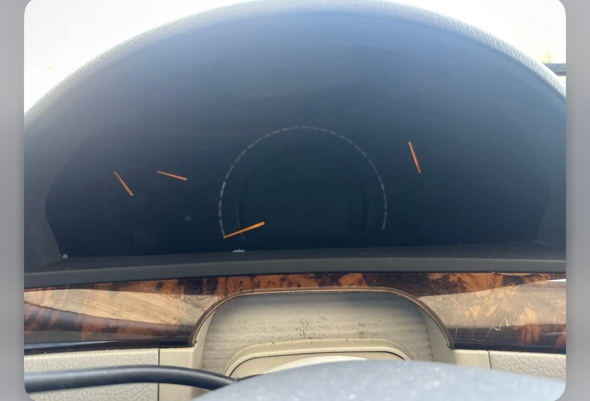

1. The instrument cluster doesn’t have backlight but the gauges still work and lights still show up in accesory but I am not able to read messages and AMG logo doesn’t light up

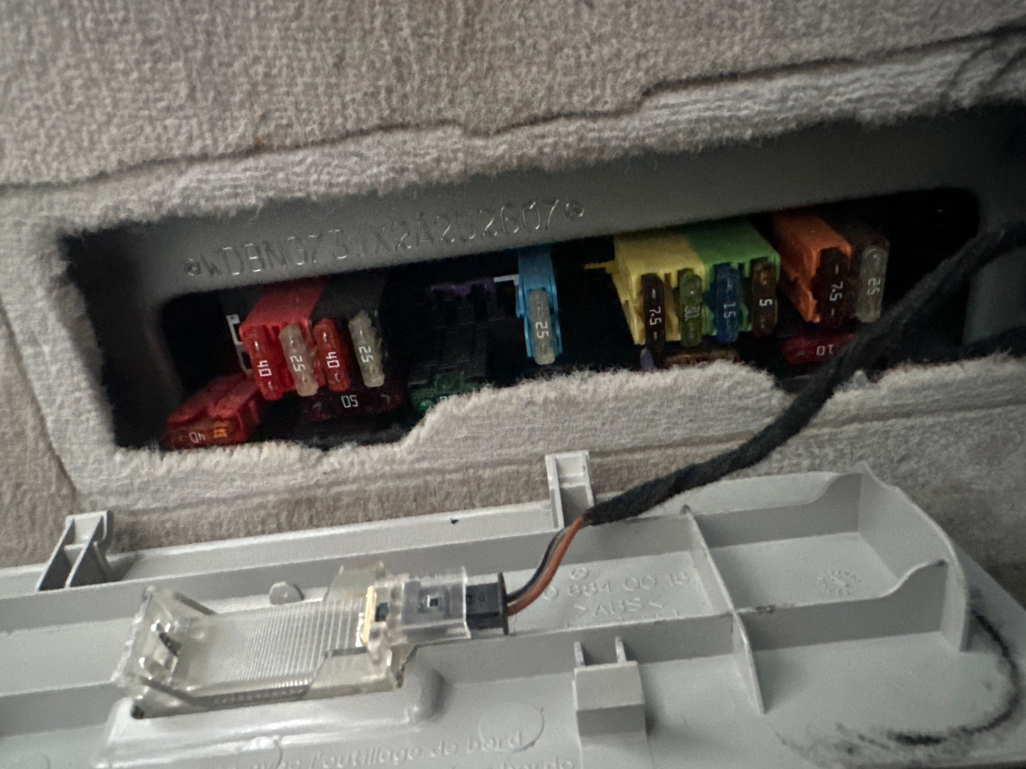

2. The locks, trunk, etc dont work and I checked fuse box assuming it was the PSE pump fuse and it had a 30a in the 20a spot so i replaced w a 20a and it blew right away
if anyone knows anything it would help please just wanting to know if its a fuse or if i need a new cluster and electrical workplease and thanks
my dash in accesory
my dash in accesory
my dash when car is fully on and started
current passenger side rear fuse box

Two separate problems the cluster needs repair there are guys in eBay that do it search w220 cluster repair
the pse system has a short in it to pop the 20 amp fuse instantly , you’ll need to trace where the short is located
