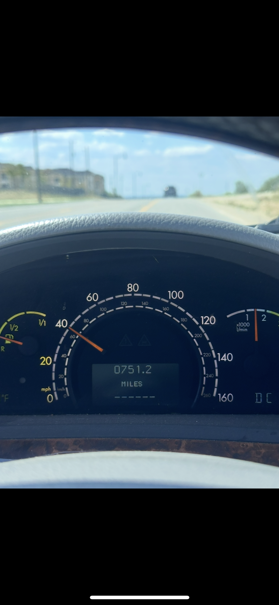

Anyways, I’ve driven the car nearly 1000 miles since the rebuild. For some reason, the total mileage and time on the dash do not appear anymore. The car did sit for a long time during rebuild, not sure if that matters in this case. I haven’t replaced any modules, fuses, fuse blocks, or anything electrical besides the prefuse block in the passenger footwell.
Do you guys have any idea how I can get my mileage and time to display again? Examples of that I’m talking about are in the pictures.

Was the dash disconnected for awhile while car moved? I think the other time a dash reads dashes like that is if ECU and odo have differing mileage. I think it requires being a few hundred different, not just a couple.
And are you also saying the clock isn’t working?

For some reason, your instrument cluster no longer matches the car's VIN. If you swap a cluster from another vehicle, the same thing happens.
Yeah, I’ve read that in a few other posts. Funny thing is, I didn’t touch the dash at all
No I didn’t touch the dash at all while the car was immobile. Yeah the clock doesn’t display either. Both showed before rebuild. Didn’t replace the dash or any modules. I didn’t put a new motor either, just rebuilt the one that was in the car previous.
