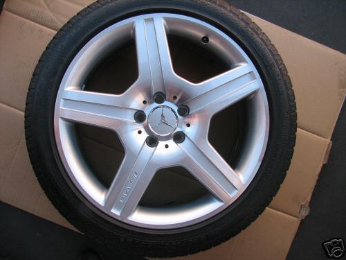

A tire and wheel expert I'm not, and couldn't find with a search. I have a new '08 S550 with stock 18" wheels. I'd like to buy a set of 19" S class AMG wheels/tires (see picture) for summer driving. Any spacers, etc needed? Will the wheel/fender well gap be unsightly?

Should just bolt on. The offsets and front and rear dimensions are the same for the S550, S63 and S65, according to the manual.

V12: As you know, the 19" AMG wheels come with the optional AMG look on the S550 on the US market. So, even though they are staggered-width, they fit without any issues re: the back fenders. Since the 19" tires are 40 aspect ratios, the height of wheel/tire will be approx. the same as the stock 18" wheels with 45 aspect ratios. But here is one area where I strongly disagree with my friend WSH. Don't let anyone talk you out of improving the tires and wheels of your S550. He doesn't believe that non-AMG Mercedes should bother with these modifications. Perhaps many of those who have spent a hefty premium on a S63 or a CL63 do not want others to know that one of the greatest improvement AMG makes on their cars in with their use of better tires and wheels. Sure, you also get a mighty powerplant and improved brakes and ABC calibrations. But you will be SIMPLY AMAZED what improvement to handling and BRAKING is the result of just plus size wheels (e.g. 19" or 20") and performance rubber like the Michelin® Pilot® Sport PS2™. This is absolutely the best 'investment' that you can make on your car and the most effective modification possible for performance & safety (braking/accident avoidance maneuvers). WSH kids me that my CL600 brakes are no better than those on a past generation C class, but I doubt he truly believes this. And yes, the S550 brakes are 'puny'...but only in comparison to the over-sized ones provided by AMG on their models. But believe you me, each of these brakes have been engineered to the needs of each car's engine & power. Our Silicon Valley friend thinks (and he has stated in this forum) that if we put larger wheels and tires on our Mercedes S/CL 550/600 even 'fat' chicks will laugh at us because of the puny size of the calipers. But how would he know? I am sure there are no fat chicks anywhere to be found in Silicon Valley. That is part of the allure of the place. They all get a one way ticket to the Mall of the Americas in Minnesota and are never seen again. Z356.

Numerous acceptable alternative tire and wheel combinations are available for the Mercedes S-Class. A good starting point might be www.tirerack.com where you can actually see various wheels pictured on your specific vehicle. Even Mercedes dealers will be happy to help you with "upsizing" tires & wheels. By the way, spacers are typically NOT acceptable.

I have an '08 S550 4-matic, that came with the standard 18" rims. Put winter tires on the standard rims, and purchased 19" AMG rims (same as your photo) on ebay for $1,200. Put summer tires, Goodyear Eagles, on the AMG rims. Of couse I bought non-staggered rims since I have a 4matic. I also picked up an extra set of TPMS sensors for the summer rims (tirerack, $300).
Everything works perfectly. No issues as the tire sizes are equivalent. Enjoy.
