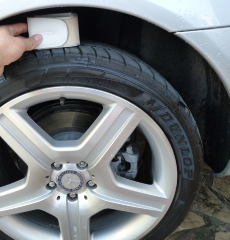

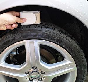

I found out the vehicle sits on side lower then on the other. Only in the back. What does it mean?? Anyone had this issue before?

Were you parked on a completely level surface? Theres only one airmatic height sensor in the rear.

What do you mean there's only one sensor in the rear? Do you mean it cannot detect if it's faulty?
The surface is completely flat or at least I'm not able to tell the difference.

the angle of the pics makes it impossible to see what the true height is. If you're really unsure if you have a problem, you may want to try using a measuring tape from the center line of the wheels to the fender lip.
Either way, I wouldn't be concerned if its a minor height difference.

I would say that you'd to get that check. Airmatic is pretty complicated, and the senors automatically adjust the height for driving conditions. On a flat plain surface the car should not be uneven. Couple of causes, leaking strut, and valve blockage. Better to get it checked.

If you have Sports ABC Suspension then you have two sensors in the front and two sensors in the rear, not one. Take it in to the dealership.

I am seeing this for few days .. one day I try to measure it with fingers, next day closed fist to see how it fits inside, next day with something else that's close
With S-Class, I'm concerned about anything that's not 100%. Even 99% might be a sign something is going wrong. This car is so complex you have to take care of it as if it was your child
