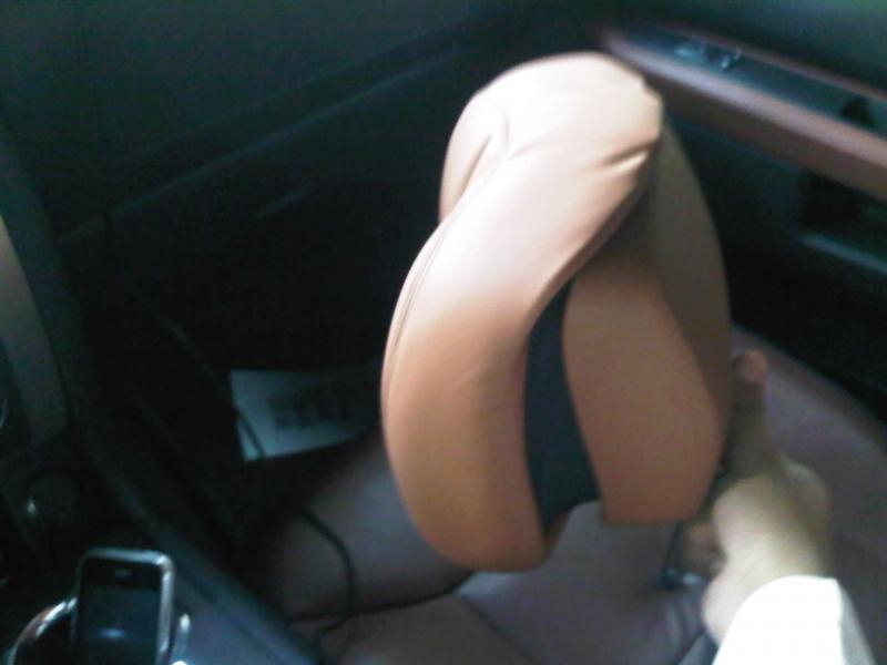

After my last visit to Germany last week I found a shop that have an OEM mercedes parts. I did ordered a Designo color comfort headrest + S65 wheels, after that I asked him about breaks. He said that he want VIN+ names of parts Or part numbers. So can you please give me the name of all the parts and quantities we need to upgrade to Euro S600 ? and I will work on the price with him
