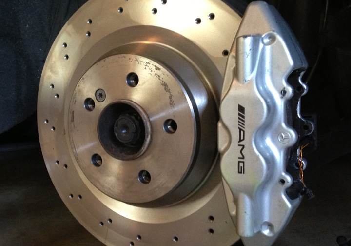

Just completed my AMG E55/SL55 brake upgrade. 8 pot front, 4 pot rear.
Everything was bolt on. No other mods were needed on my installation.
S550 (non-4Matic)
Here's what you need, most part from autopartswarehouse
1) 2006 E55/SL55 front and rear calipers, front E55/SL55 rotors, rear SL55 rotors. (E55 rear rotor will not work, it sits too deep.)
2) AKEBONO EURO ULTRA-PREMIUM BRAKE PADS, CERAMIC (AKEUR983 - front set) (AKEUR984 - Rear set)
3) Zimmerman Rear SL55 AMG Rotor (W0133-1822290)
4) BG Brake silencer liquid for pads, silencing paste for edges and rear of pads.
They look awesome, so much better than stocks, and way more stopping power.

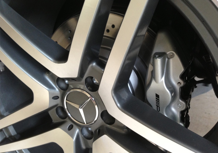

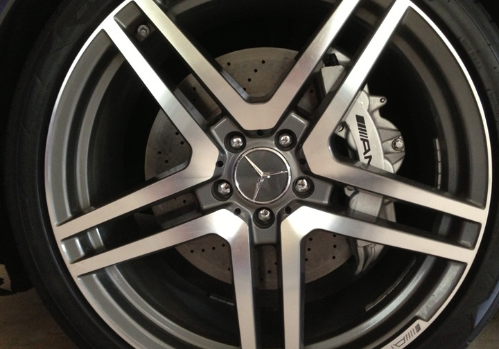

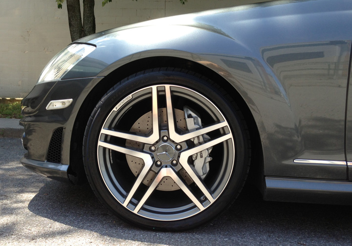

Old Jul 14, 2013 | 01:33 AM
bensitto's Avatar
Joined: Jan 2003
Posts: 1,338
Likes: 34
From: Germantown, MD
S550, R350, GL550, ML63 AMG
More pix of the BBK.
