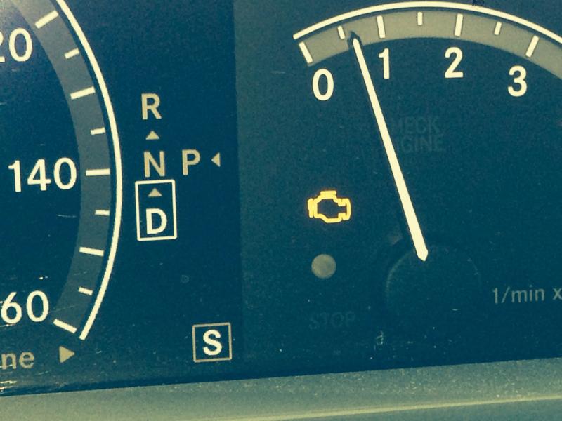

I am the new owner of a 2007 S 550 with 44k miles.
Over the last month I have noticed that the engine light comes on every time the fuel level reaches the 1/3 level. (4 times over the last 5 weeks) I have checked the fuel cap it's tight and the car seems to run fine. It goes off within 3-4 hours of refilling the tank.
I stopped by a pep boys to have them check for codes it came back clear. But by the time I got there the light was not illuminated. I have not had time to get to my mechanic yet but I figured I'd run it by this group first. I did a rudimentary search on this site but couldn't find any clues to why this is happening.
Thanks in advance for any advice.

It's very unusual for the engine light to come on without the car displaying a corresponding fault message on the info screen (in the speedometer display), but my 2010 did the same thing last week over several days. Just when I was planning to take it in to have it checked it cleared by itself and I haven't seen it since.
The car isn't shy about complaining very specifically when it needs attention, so whatever it is it can't be serious.

Thanks for the reply. No fault messages on display. The light always goes off with in 1-2 hours of filling the gas tank. This week the light came on just as the gas level dipped below 1/2 full.

I just had a similar issue with a 2010 S500.
The gauge would report 2/3rds 3/4qts even when full. The light was coming on at funny times.
I was expecting a new fuel level sender etc... But turned out to be just software.
The dealer reflashed the rear SAM, filled it to 100% and re calibrated fuel gauge. Working perfectly now.
