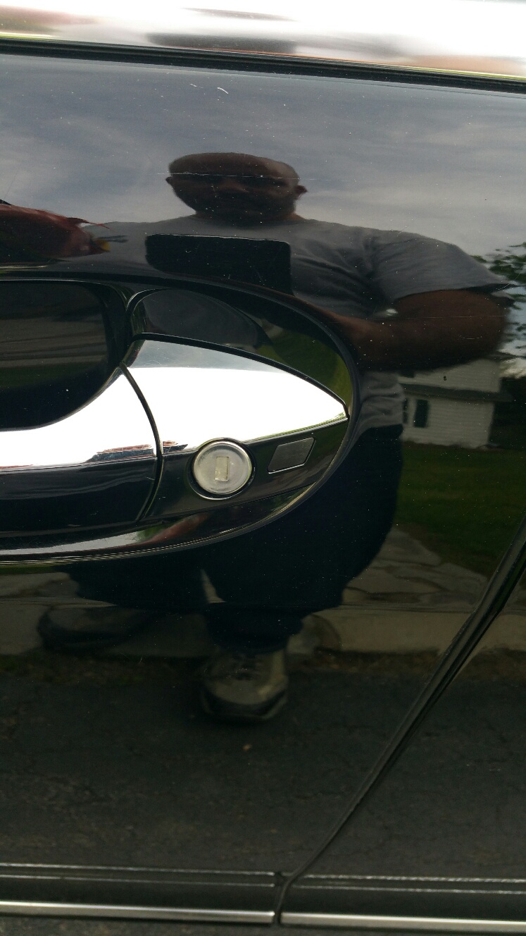

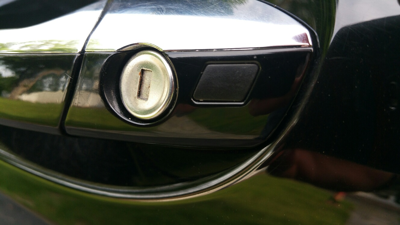

My car has the diamond/square shape portion by the door, but when looking at it closely, it doesn't appear to be transparent. Could the cars without keyless entry possibly have the cut out with a black delete piece, but not the sensor for production/cost reasons? Look at mine and tell me if it resembles yours. I would think it would be transparent to some degree.
Old May 29, 2015 | 05:41 PM
MonroeHandyMan's Avatar
Joined: Apr 2015
Posts: 169
From: Monroe, NY 10950
2007 S550 4Matic 2009 ML350 4Matic
Some pics. I tried to lock and unlock my doors by touching the handle and it doesnt work for me. Only with my remote...
Attached Thumbnails Possible to Convert 2007 s550 to a Push Button Start?-20150529_172736_resized.jpg   Possible to Convert 2007 s550 to a Push Button Start?-20150529_172142_resized.jpg   Possible to Convert 2007 s550 to a Push Button Start?-20150529_172058_resized.jpg
Old May 29, 2015 | 05:48 PM
WHPH28's Avatar
Joined: Nov 2014
Posts: 1,560
Likes: 208
From: Maryland
Depends on the weather
No, you don't have it. There would be one on the actual handle itself also.
Old May 29, 2015 | 05:54 PM
Joined: Apr 2015
Posts: 169
So I would have to change the handle as well? I am not intimidated to update as one of my local junk yards currently has 5 s550's and I think 2 s600's 2007 and up. Owners are friends of mine. Parts are relatively inexpensive by comparison to Benz prices for me. I would like the keyless go feature and push button start if I can do it...What's needed exactly if known?
