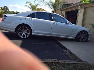

Pic attached
Looks like is lower on the driver side at least in the rear.
When I turn the car on I can hear the pump on

If you're lucky it's just the one rear strut or air line. If the compressor failed the whole thing would drop. It's important not to drive the car with the air system "opened" like that. The compressor can burn itself out trying to replace the lost pressure. Get it towed to a shop.
