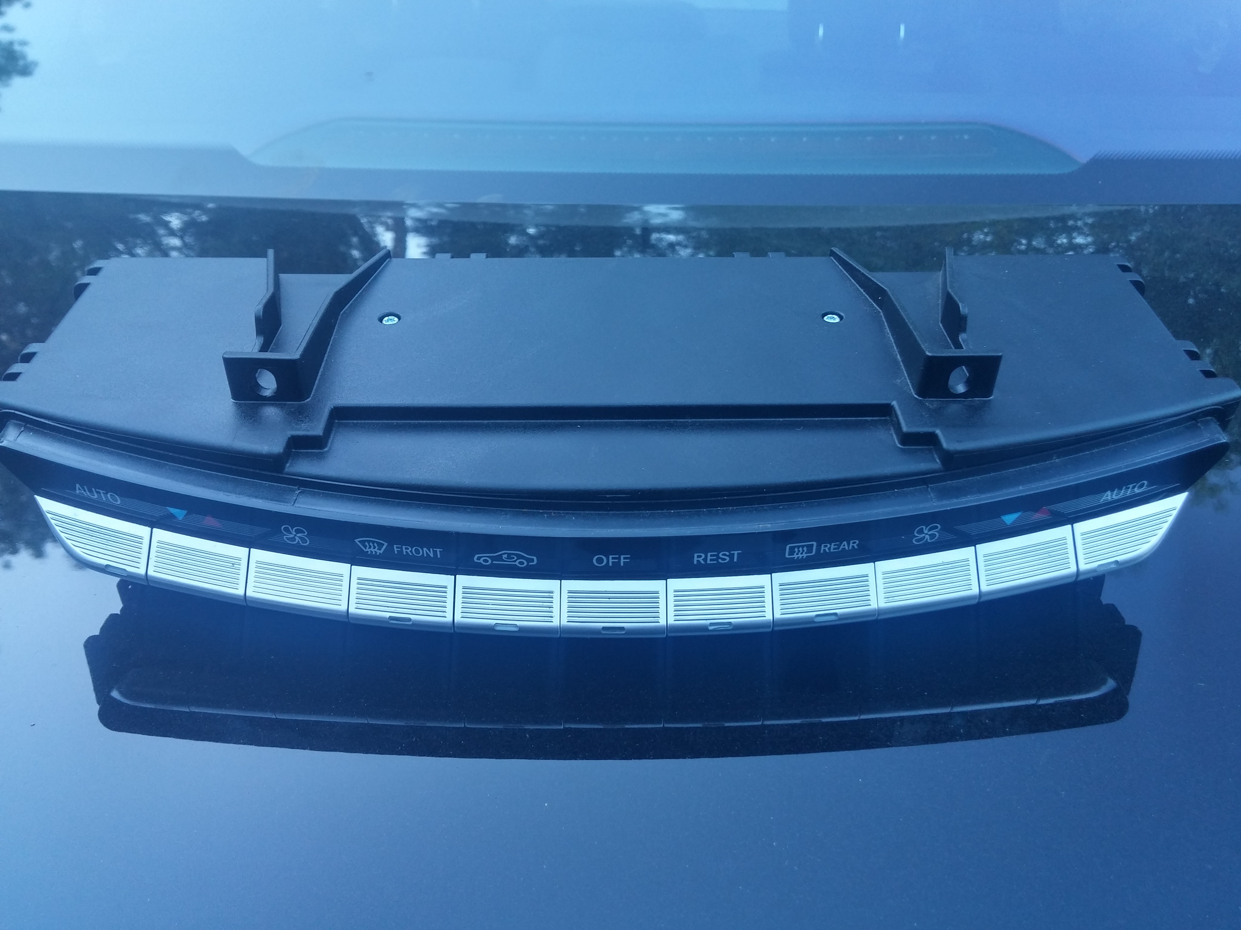

Found out from the dealer this morning that my S550 need a special module. This module controls the inner electronics, such as the display clock, the controls to the left side of the COMAND screen and the night vision. Big question…… does anyone know the number of this part? Greatly appreciated?
For what it’s worth……..when I originally started this thread……. I was trying to nail down an electrical problem that plagued everything in the car. Clock, night vision, lights, and controls for the display screen. The problem is now solved, and it was the “center climate control” 221 870 26 58. So I am now a happy Man.
