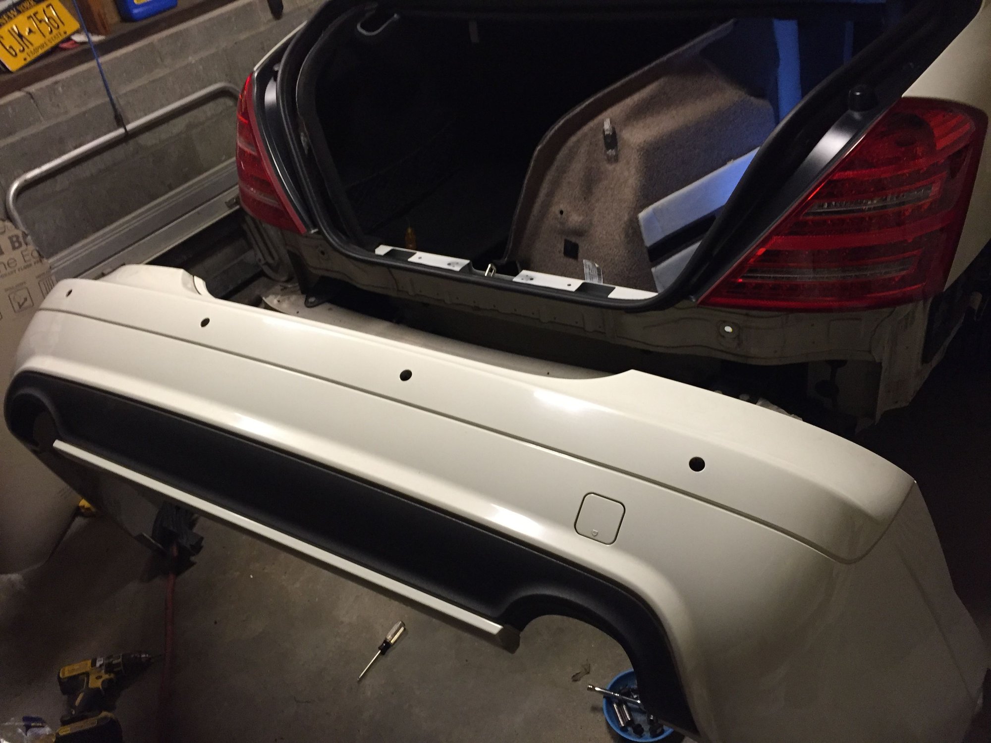

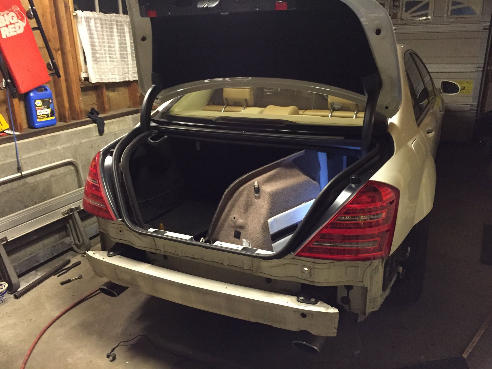

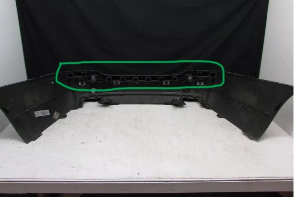

I finally got the rear bumper off. Way harder than the front in my opionion. I think I made a mistake assuming the Skelton of the rear bumper would be the same as the 07-09. The bumper I bought came with no plastic Skelton parts in the rear just the cover. Has anyone swapped the plastic pieces. Looks almost impossible to take off the old one as the tabs seem melted to the bumper. Ahhh ohh. The setup looks slightly differnt too. Anyone have part numbers???

Anyone have any suggestions or know the part numbers to the inside bumper? I think the dealer won't sell the Skelton piece they are saying its part of the bumper?

If anyone has a 2010++ old rear bumper that was damaged or anything I will buy that back skeleton piece from them...Please let me know.

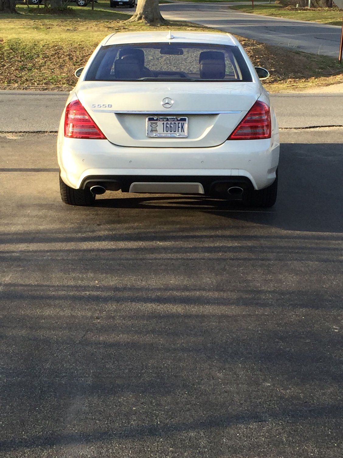

Got the rear bumper on. Bought that plastic piece out of California for $200. Hopefully if someone sees this they won't buy a Rear bumper without that cradle piece. Mercedes won't sell it so you will have to bother 100 ppl on eBay and hope one person will sell it. Anyways scheduled to have the rear exhaust put on tomorrow. I'll
Post the extra parts I had to buy and prices. Roughly I'm at $3000 with me doing all install work except pain . All parts are oem except front grille and exhaust. I'm very happy.

looks good. cant beat OEM fitment

Looks good, and the exhaust will be the icing. Appreciate all of the info!

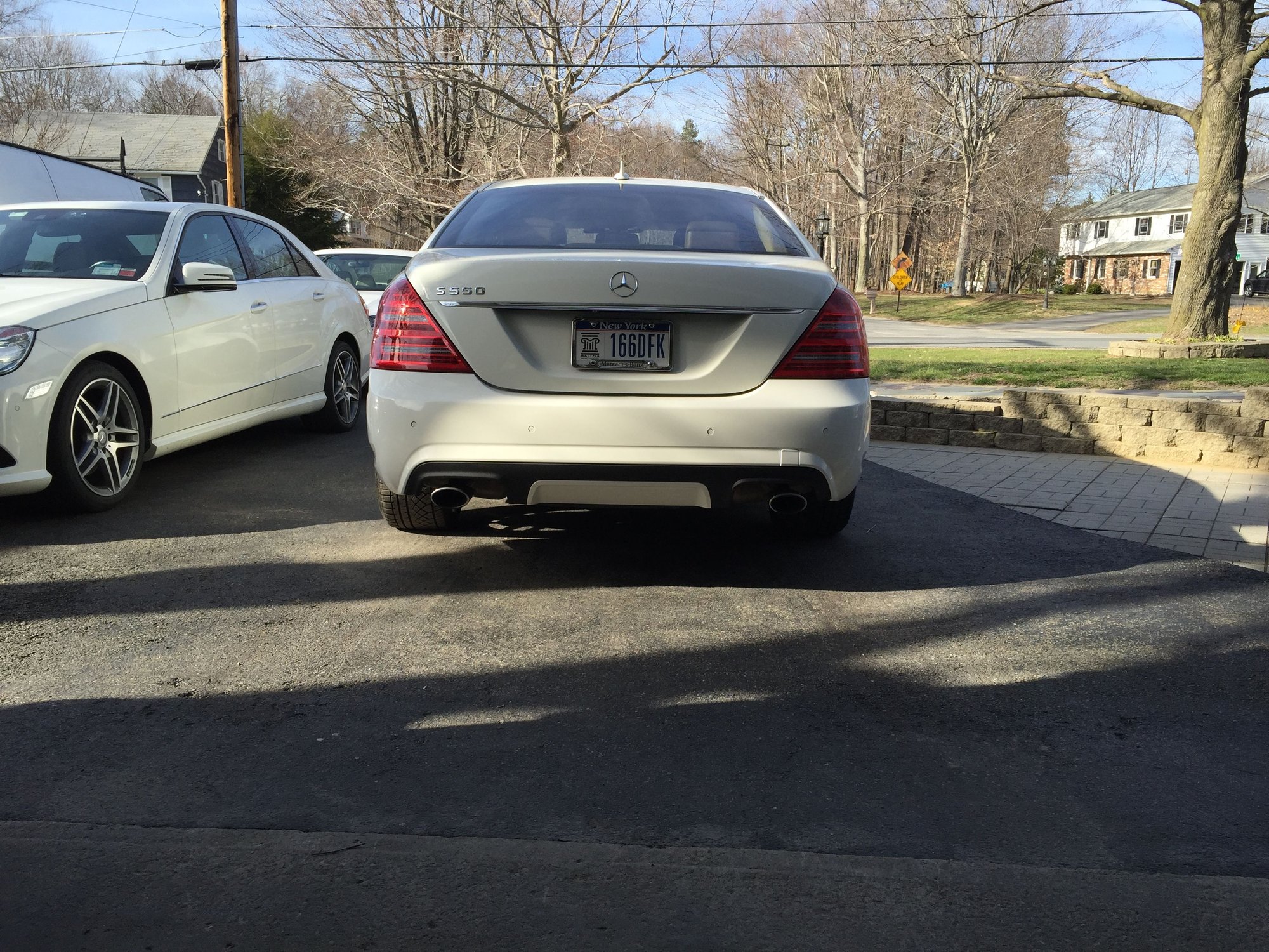

gonna put up the photos later. Got the exhaust done.

nice. for $3k you made your car look like it's worth $50k instead of 20.

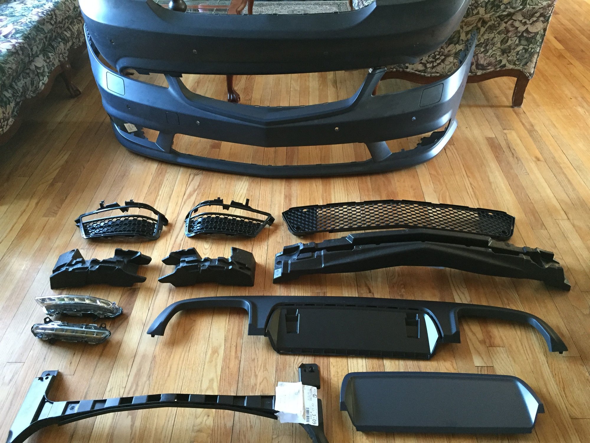

As to help anyone who takes on this project this should save you many hours with the parts counter...Im not a professional in any way and figured this out with no special tools. It could be done in 1 to 2 days easily if you have all the right parts.... This was everything I needed to buy and I used some brackets off the old bumper, such as the side rear bumper brackets.. I actually wound up taking the old fogs lights off my old bumper putting the old fog lights inside of them so they stayed sealed. I than zip tied the old fog lights up inside the bumper so you don't see them and black taped everything so no light shows if the old fog lights ever come on.
Final breakdown of part numbers and cost finished project to convert 2007 AMG package s550 to 2013 S63
Front Bumper $500 A 221 885 30 25
Rear Bumper $250 A 221 885 18 25
The front bumper needs 3 impact absorbers
A 221 885 8337 $116 Middle one
A 221 885 6137 $60 Left side
A 221 885 6237 $60 Right Side
Bottom of the bumper has whats called a "Stay" keeps it in place on bottom.
A 221 885 0136 $40
A 221 885 2053 $50 Fog light plastic grille Right side
A 221 885 1953 $50 Fog light plastic grille Left side
A 221 885 0953 $88 Front Mesh plastic on bottom of bumper
A 221 820 1356 $258 fog light left
A 221 820 1456 $200 fog light right
A 221 885 25 23 $50 Right bottom corner plastic that wheel liner will sit behind
A 221 885 26 23 $50 Left side of this
A 221 885 2325 $185 rear bumper diffuser
A 221 885 32259999 $101 rear insert that goes into the diffuser
A 221 440 33 09 $35 Fog Light harness wires so you don’t have to hardwire the fog light to the side marker. Not needed but makes installation much more clean and gives you extra wire.
A 221 885 20 23 $32 rear bumper holder in bottom corner
A 221 885 21 23 $32 other side rear bumper holder in bottom corner
A 221 885 32 14 $28 bracket that holds the rear diffuser to the car Right side
A 221 885 31 14 $28 Left side same bracket holds diffuser to the car
Rear bumper cradle $200 (make sure you buy one with this installed don’t make my mistake see pics in post)
Exhaust tips (eBay) $260
Howell grile (eBay) $229
Paint Bumpers $407
Weld exhaust tips $35
$20 in misc push pins that you might break.
Total Cost
$3364

The fog lights in the picture were the wrong ones so I gotta ship them back and return them for the part number listed above.
Going to take the bumpers to the body shop and have them painted. I got everything figured out except the issue with the fog lights. I have heard if I hook up the existing fog light wiring to the new ones it will throw a code. Research has shown that I can buy a 50 ohm resistors but they get hot and can over heat. Another option is to tap the side markers and get it from that. Still have no clue how to do it. With this bumper there are no side markers, some have them some don't on the s63 depending on year. So I'm not sure since I don't need my side markers anymore if I could just use the wiring and hook it up to the fogs. I'll update you when I figure it out. Maybe someone knows a solution to get no error for both having no side markers now and having the fog lights on. So this is where I am at now. I'll make posts when I figure stuff out.
Gonna attach photos of the stuff.
