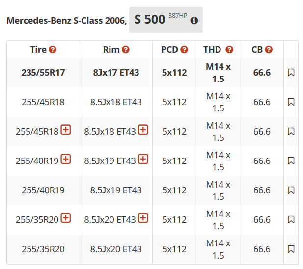

Anyone have experience with the following dim on S500 w221?
Front: 245/45/18
Rear: 265/35/18
Compared to the chart, this size is not "compatible"..?
The rims are 5x112 ET43.
Also, does anyone know the name and price range of these rims (as I consider to buy these second hand)?
These have been on a new E-class.
Thanks!

those are going to be too small. For reference, my stock 19's came with 255/40/19 front and 275/40/19 rear tires. Also, the offset on the E is different from the S

Hi, thanks for your reply.
The offset was ET43 (not ET48 as I wrote first), so I guess the offset should be fine.
So whats the downside of the dim, except 19" or 20" looks cooler
The table I found online state that you could have 235/55/17 as well...
But I cannot find the dim as the rims I'm interested in have.
Thanks!
