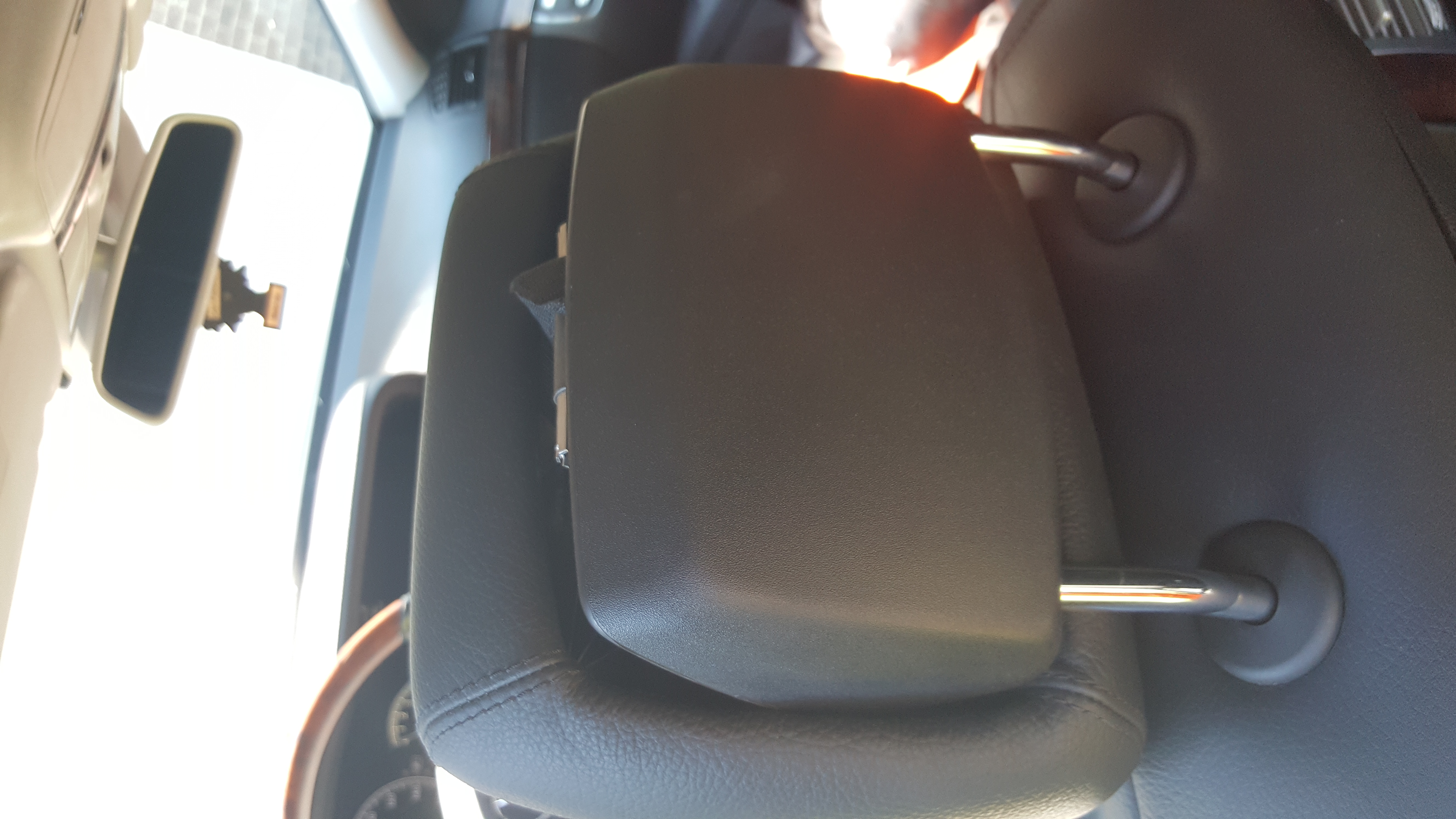

Also any info on replacing my broken headrest. It has been broken for a while so I might as well get this fixed too.
Attached Thumbnails Immediate Wheel Help Needed!-broken-rim-1.jpg   Immediate Wheel Help Needed!-broken-headrest-1.jpg   Immediate Wheel Help Needed!-broken-headrest-2.jpg

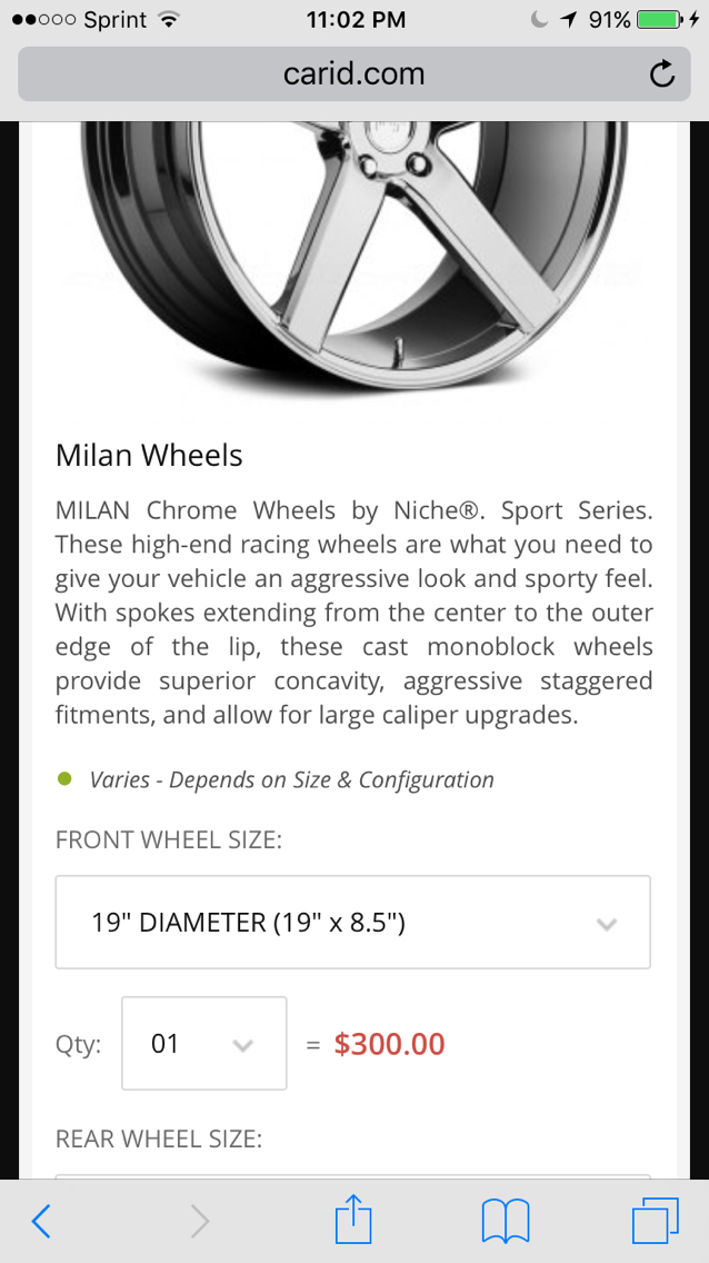

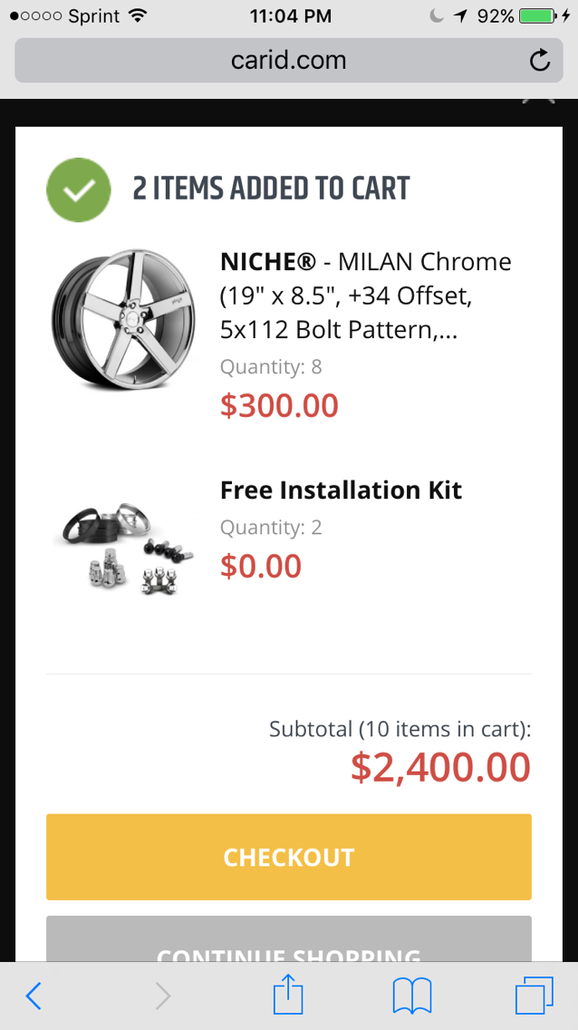

CarID.com has your wheel in stock:
