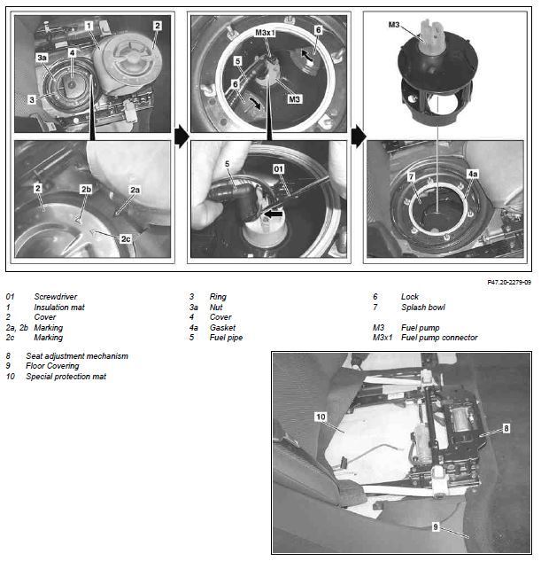

what is this below the rear seat cushion?
This is found below rear seat cushion covered by sound-deadening material. Looked a bit like a speaker but I am not sure what it is. The sound-deadening material on the seat base is neatly cut as a circular flap so it can be lifted up to gain access to this. I am just curious Car in question is 2012 S class with rear seat package, rear AC, fridge and rear seat entertainment.

prb access to the fuel pump.

That's where the fuel filter is.

Nice! Pleasantly surprised to know that fuel filter and fuel pump are so easily accessible. The reason I am looking under the seat cushion is some sort of weird decaying rubber smell coming from the black sound deadening layer. I got rid of the carpet footwell mats because of the stink coming from their rubber base layer. This layer is probably there everywhere but it's covered by the carpet except under the rear seat and inside the center console (rear A/C blower sends out stinky air). Anybody else experienced this issue? Will putting a layer of tape on this sound deadener stop the off-gassing? I can't believe Mercedes used such cheap crap.
