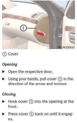

Check fuse, 79 @ right instrument panel.

can you say, which one is 79? Trying to get the cars fuse diagram to find a #79 fuse. Thanks.

Found and checked fuse #79. Its o.k.--tried a new fuse at #79, same rating,--still persistent issue of key fob.
