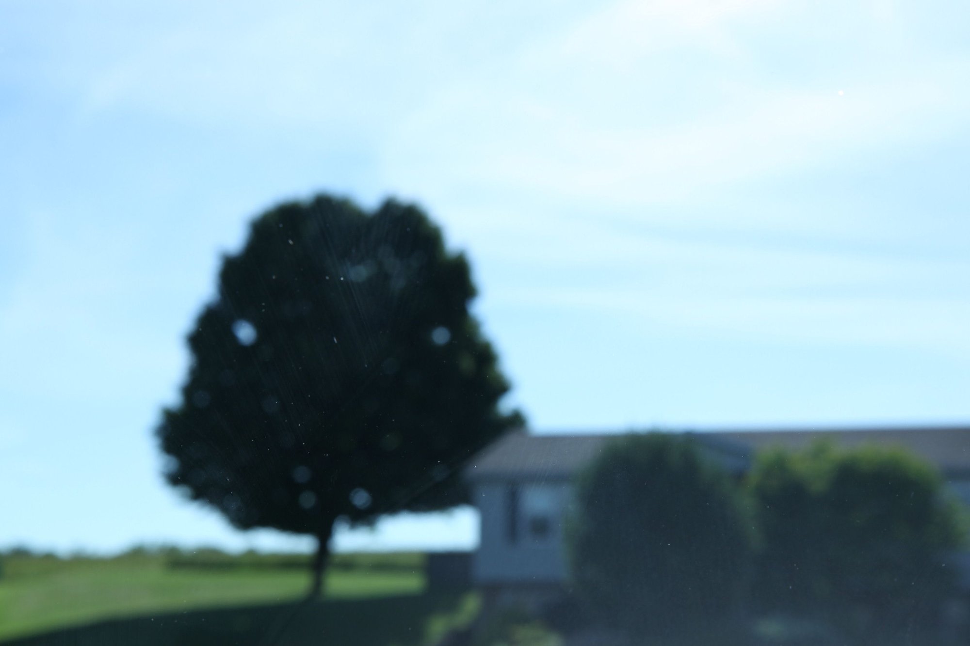

Could you help with two questions?When I had the car delivered back to me the windshield was dirty on both the outside and inside.Some of it appeared to be from insects and pollen from outside and the road but that did not explain the inside.The inside is dirty as shown on the attached picture.Since the installer and dealer is over one hour away and based on my past experience, I would like to try to take care of this myself.What is the safest and most effective way to clean the inside since there is a UV coating on my S550 windshield?
