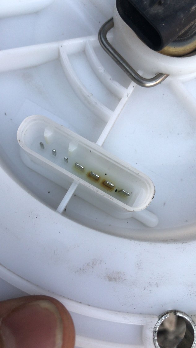

- engine dies
- fuel filter gets burned
* the fuel filter burning

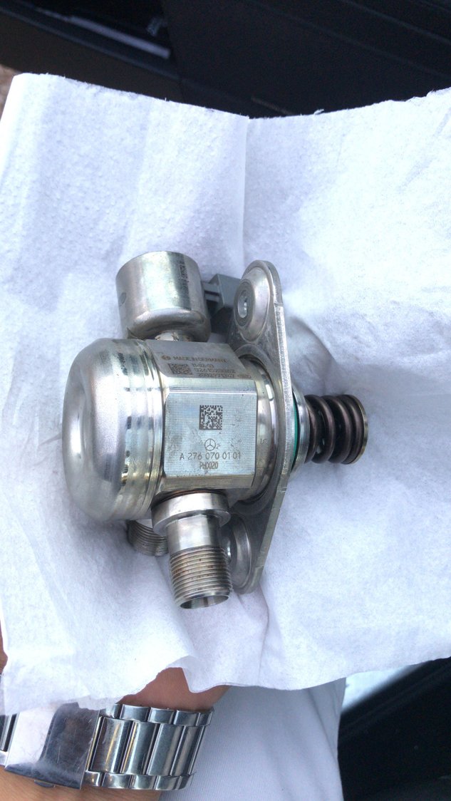

High pressure fuel pump
things ive change so far and no results :
- fuel pump ( 3 times)
- fuel filter ( 3 times )
- high pressure fuel pump ( mechancal fuel pump )
and still no results pls help
