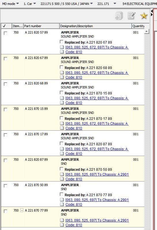

Definitive diagnose have someone check using MB DAS (diagnostics). DIY, start with amp in trunk here are compatible part #s if replacement is needed. Note upon replacement coding may be necessary using MB diagnostics.
