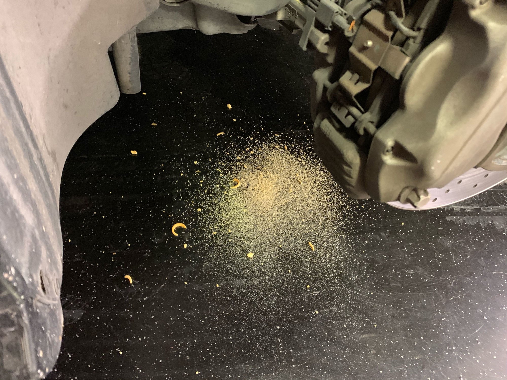

Noticed a couple days ago while stopped at a traffic light the front end, more noticeably on the right, started to rise. At my destination I used my fingers to measure tire fender height gap left with right and right was absolutely two inches lower than left.
I read on this thread and thought I’d check the ride height electrical connections for dryness and cleanliness.
As I used my floor jack to lift the right front wheel, a lot of air bleeding out came from the right front.
I let the car back down and it went to the bottom.
I jacked it back up and removed the wheel. As I moved the bellows up, a bunch of yellow powder dumped out, so I took a photo.
After putting the wheel back on and starting the engine, the compressor lifted the corner back to about where it was prior, meaning too low.
I guess time for a new air strut.
edit: I found a year youtube video by Arnott on how to replace. Very simple, but doesn’t state about if needed to bleed off any air before removal??
Should both sides be changed?
