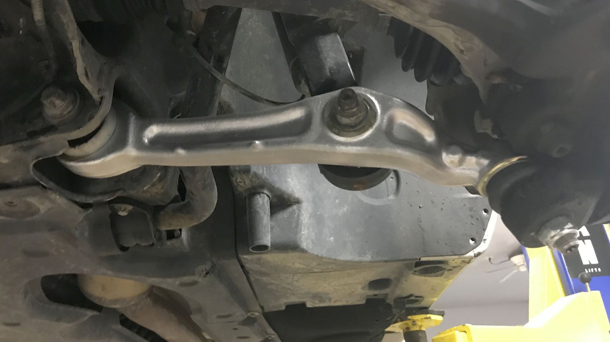

I installed the new Control Arm this morning,

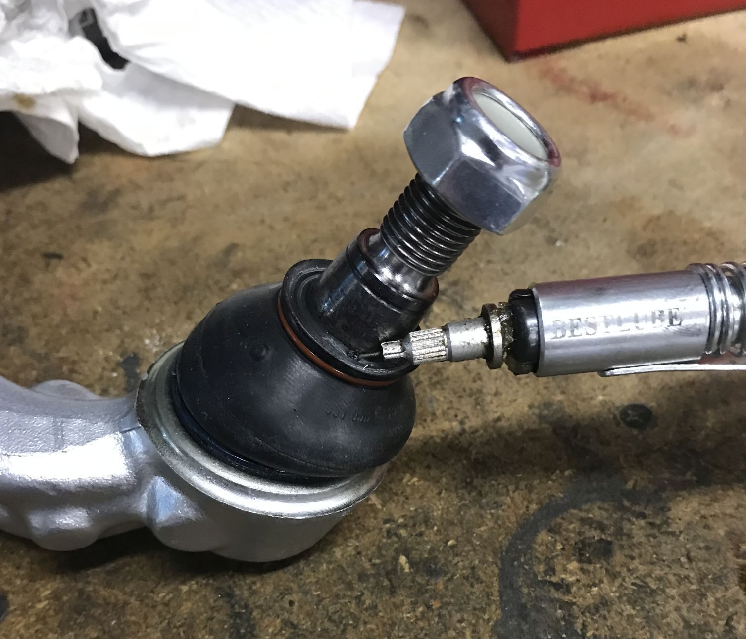

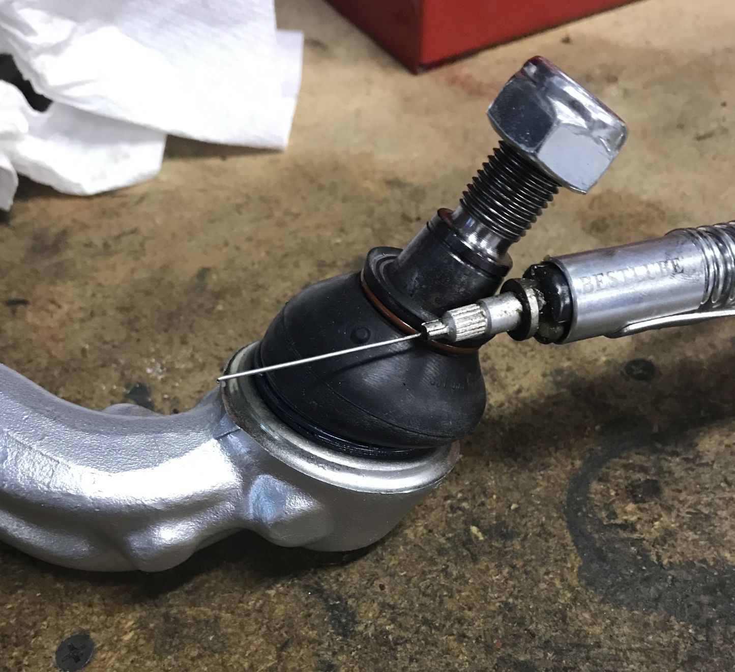

First I greased up a couple of the BJs with a needle on the hand pump grease gun.

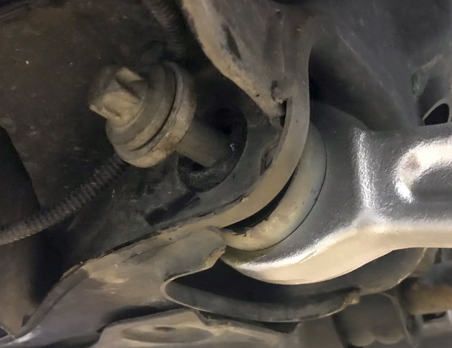

The bushing bolt has a star/Torx head. I used a standard 6-point 17mm socket. You just need to hold the bolt... the real tightening is done on the nut side.
The bushing nut needs to be tightened by hand with wrench. there is no clearance for a socket. I used a 13/16" box wrench.
(The bushing nut/bolt should be tightened with the car on the ground... in ride height position}
I could get my impact on the shock and LBJ nuts, then finish torqued them by hand.
I took it for a quick drive. Seems to be OK. Steering wheel looks straight.
(The correct thing to do is get the alignment checked, but I don't know what can be adjusted, except the tie rod (Toe).)

WONDERFUL photo-documentation !! Good Work. One concern Adding Grease with a needle ---correct insertion of needle is as shown, but Is the added grease compatible with that in the joint already???
I strongly discourage adding grease to ball joints and tie-rod ends.
Unless the protective rubber 'boot' is torn or damaged and leaks oil out, the joints never need additional grease. There is much more lubricating oil in the original amount than needed for many 'lifetimes.'
'GREASE" is the name for a metallic 'soap' (such as lithium hydroxide reacted with an animal fat) and then mixed in an oil (which is the lubricant.) The 'mixing' involves both ordinary stirring and very high 'shearing' to form the sponge-like matrix in which the oil is held. The soap used, amount, and degree of shearing are controlled to give the desired 'stiffness' and oil delivery characteristics. Oil must 'weep' out of the matrix at the proper rate into the lubricated joint.The most common number 2 stiffness (range is from 00 to 6) grease contains about 3-5% 'soap' and the balance oil and perhaps an additive such as molybdenum disulphide (2%) for extreme pressure applications such as Ball Joints.
The different 'soaps' should not be 'mixed,' as that can adversely affect the oil delivery to the lubricated joint. The different soaps can react with each other and cause breakdown of the 'matrix' allowing the oil to separate and leak away from the joint to be lubricated. Adding grease to a sealed joint such as ball joints and tie-rod ends can cause early failure from 'lack of lubricant.'

Agreed. The Ball Joint manufacturers are very specific about the "grease" they use on their BJs and they do lube for "life".
Apparently, the "life" on my BJ was less than 82,000 miles.
The incorrect grease could greatly reduce the life of your BJ.
I don't know what grease I added, and it's unlikely that you will find the correct OEM grease at the local Auto Store. So, you are taking your chances.
I'm convinced that adding grease fixed the creaking on the passenger side. Maybe it bought me a little time.
I'm convinced that the driver side was clearly the LBJ in the control arm. (it had a busted boot and end-play)
I may also be wrong. I'll post updates either way.
