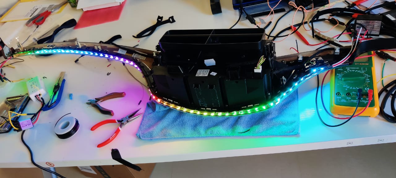

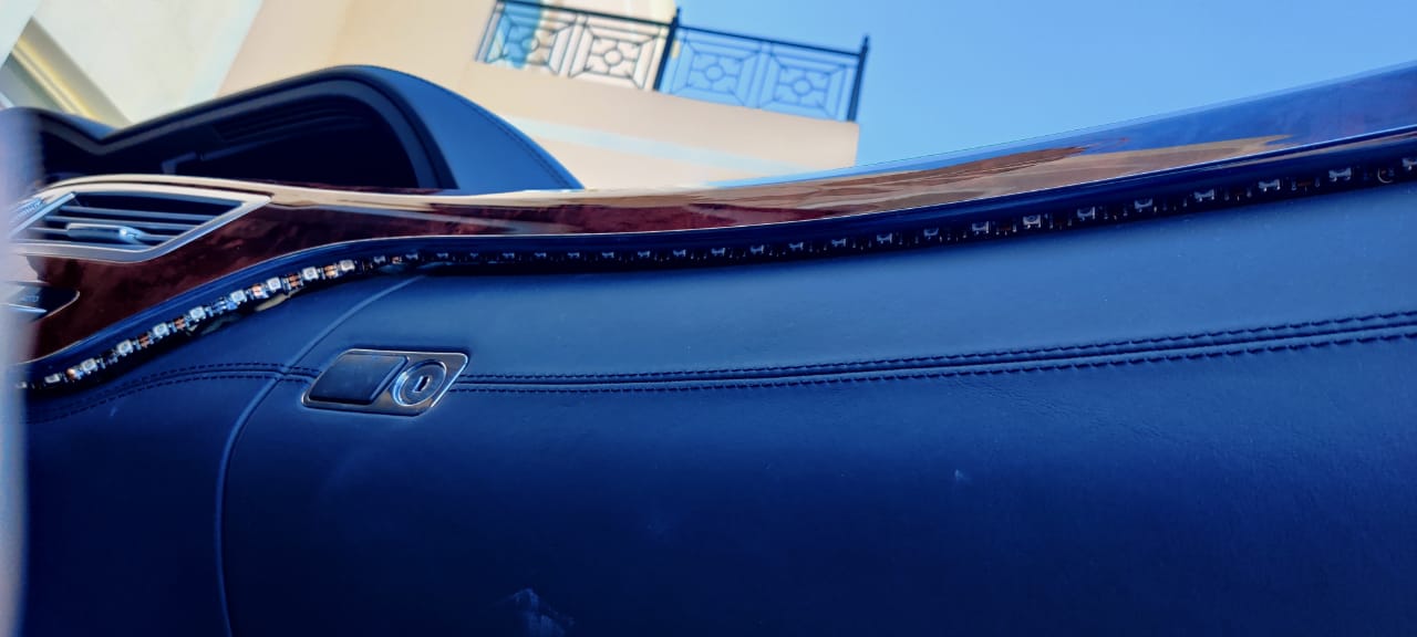

I was trying to be a bit more innovative here and fit some programmable LEDs, play along with the comand and enable some form of control using factory buttons... but it turns out LED strip based on WS2811 simply won't fit... and even if you can squeeze it in, it looks like crap, especially around central console when you are sitting on passenger side and look at the central console - these are just not elastic enough to pack them in a way that would allow nice and smooth bends.... Tube-based LED seems the only aesthetically-acceptable solution here
If anybody finds any programmable LEDs that fit in a 5mm tube, let me know :P I am not giving up just yet, just returned to OE ambience...
How does it look wit the lights on while on the dash?
I got sk812 5mm let's that may fit in a 5mm tube.. they also have ap102 led which are 4mm but they are expensive .. they cost like $40m... for the whole car your looking at around $200-250 for just the straps not including wiring & other stuff & leds that small use 5v so you will need a step down voltage controller

Also if u remove all of the black plastic trim on the dash and door pieces & mount the leds to the silver tabs the black pieces connect too, they will tuck into the trim better & you may not be able to see them when the car is put back together.... but you will not be able to use the clear plastic that comes with the car if u use that method... the only way to combat the bends the strips can't make is by cutting & soldering together or using multiple shorter strips.. it will not make the whole dash run as 1 piece
I will show pics later

The challenge is that these 10mm RGB tapes don't bend the way you need them to bend around the central part of the console. Fitting them is a real problem... is simply no room to hid them behind the trim under HVAC controls - passenger will always see these and it is not pretty, unless you find something _much_ smaller. Having said that - I ordered some 4mm addressable RGB ;-) As a backup, I also picked some classic 5mm tubes. If I can't address each pixel, at least I'll have a nice solid color setup...

You can create your own string of LEDs...however I think the problem will be diffusing the light. Ambient lighting looks great if you're looking at indirect/reflected light, not the LED strip directly or light pipe. If you already have the light pipe in place simply swap out the LEDs for some larger ones. It'll be more than bright enough.

4mm will definitely fit but you still may not be able to use the clear light tubes...
