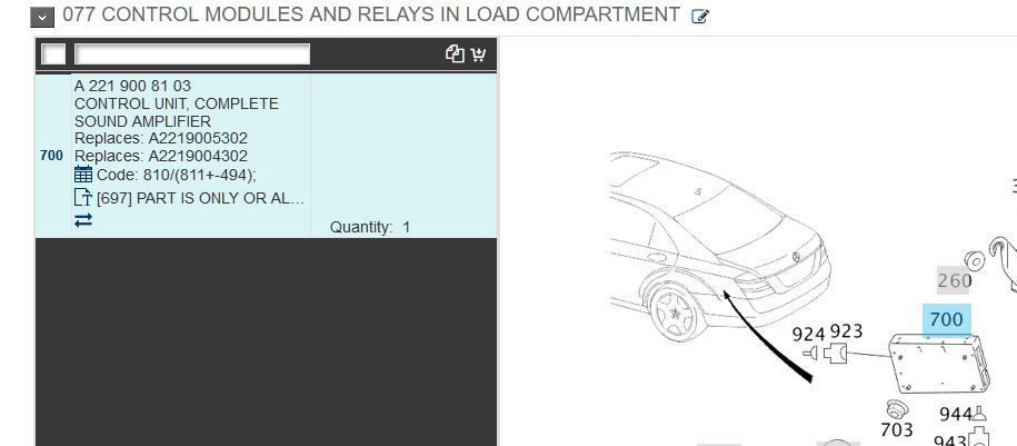

Have someone pull fault codes using MB diagnostics could be any device on MOST malfunctioning reluctant to do so and in a rush to replace parts, start with amp here are compatible part # for replacement.
