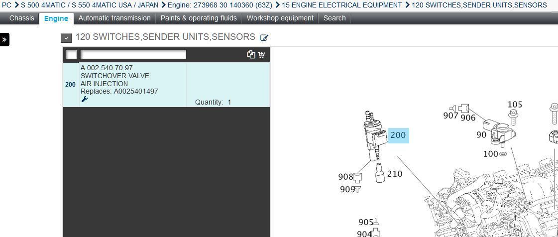

I couldn't find part number.
Broke off one line, and now need to replace it.

Looks like air injection switchover valve. EPC shows part for your VIN however, online vendors claim not compatible check part # installed.
