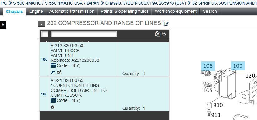

Wonderful evening everyone, I purchased a used suspension valve body and the car read as bad. I talked to a mechanic and he said that being a MB part it most likely has to be programmed so that’s my question, does a replacement suspension valve body need to be programmed?

Plug & play, see attachment. In a worst case scenario you may need to erase stored fault codes but not common.

You sir are a lord that attachment is exactly what I needed. May the gods be with you haha.
