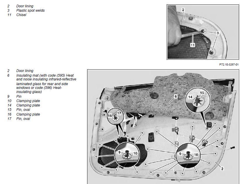

Anyone have any idea how to remove the front speaker cover? i tried pulling them off so hard but still wont come off.

Remove door lining, need to disengage plastic spot welds.

Yeah you really need to take the whole door panel off.
