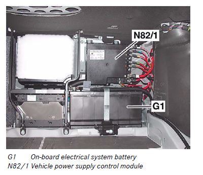

From what you have explained, it appears that there may be a parasitic draw on the battery located in the trunk of your vehicle. This battery supplies all on-board consumer electronics, and will drain if a consumer unit is continuously drawing a current from the battery while the vehicle is stationary. You may need to inspect each of the consumer unit's fuses to determine whether or not a particular circuit is drawing excess current and draining the battery.

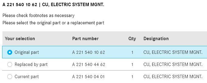

One or more control modules may not be shutting down after shutoff causing battery to drain. Or cutout relay located inside power supply control module may be malfunctioning. MB does not offer this part separately but it may be available online once part # is identified. Here are compatible control module part #s to shop if this found to be the problem. Yes, key problem may be linked best to have someone check using MB diagnostics.
