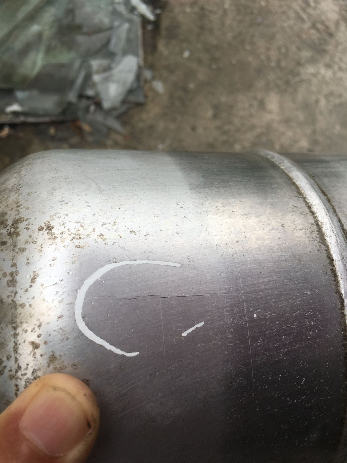

It leak on the air hose, distribution valve or air pressure tank, and I realized that most of the tank is cracked after 10 years in use.
