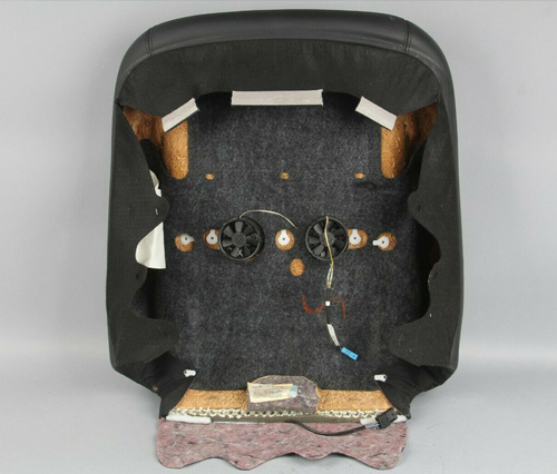

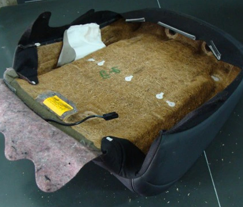

I checked several photos of removed seat (ebay) cushions and it looks like removing all the buttons frees the entire cushion and that should be it:
Any hints how to get on with this task?

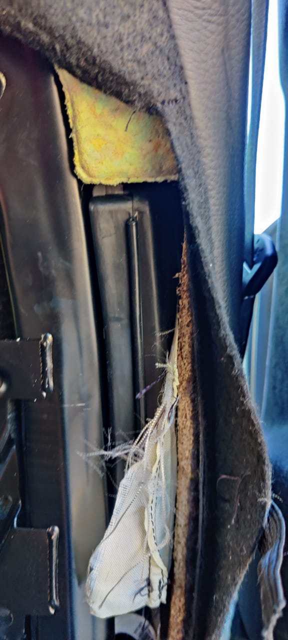

I'm done... all in all nice and easy job. The seat cover is held by two clips in the center of the seat, two springs and what was the most bizarre thing to me - a fabric tape around an airbag - it appears that this tape is being stitched after the installation, so there is no way around but to cut this fabric in order to separate the backrest from the frame. Removing the headrest is also straightforward - then you need to also remove the plastic guides for rails - and you can start detaching the seat back cushion.
Once separated, I managed to easily work on bladders. Mine have cracks in the inlet - the place where the air hose enters the bladder - not much can be done unless I can get something like a really strong adhesive and construct a small mold around the entire joint to fill it out and let it cure for a while... maybe I'll do this one day. For now - not a priority. I do not like the way it feels when it is all inflated (it's too tight for me), and I also do not use the dynamic seats feature, so who cares... The most important thing for me was to adjust that central set of 3 bladders making you feel like you are sitting on a football when all are inflated and two of them do not respond to controls. I managed to unlock/unclog valves by playing with DAS (inflating and deflating while squeezing bladders with my hand). After few tries it started working again and I am happy with the outcome.
