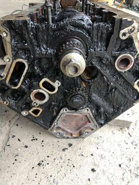

Do you know what is the main contribution to make engine oil of M273 become grease? Is it due oil change is not following recommended interval? Fake engine oil? Oil grade is not correct or any part of engine is defective?

Most likely just not changing oil, although I would have a hard time believing that was synthetic oil. Might also have been running hot. I've seen a failure like that at about 60k miles. Engine failed on a cold start because it couldn't pump cold grease. Pretty sure oil was never changed on that one.

@Minh What is the history of this engine? Model year? Mileage?

This M273 engine manufactured in 2008 with around 200,000km on it.

I suspected that problem is might not realated to mineral oil or synthetic oil as well as oil change interval. Problem might due to compression is lost therefore a mixture after fuel burn on combustion chamer is enter oil pan and under pressure and heat cracking is happen to make oil become grease.

that's not grease its sludge
nasty oil, nasty driving, too many short runs, too much heat, cheap oil, oil left in too long, cheap nasty petrol etc., that bad on a high tech engine is not good news - prob best to put it out of its misery - if that's the way it was used and looked after the rest must be pretty sorry

if it was operated correctly, with the right materials and never overheated, it would look like new inside regardless of miles

@Minh Thanks. In which geography/country/part of the world did this engine accumulate the 200k kms?

This engine is operating in Vietnam.

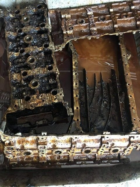

I would say the oil was not changed, and the engine may have been run out of oil. The sludge in the front timing chest has nothing to do with compression or combustion.
Also agree with alot of short stop/start driving conditions. The engine likely spent alot of its operating time below full operating temperature.

Oil not changed AND NOT Mercedes spec 229.5 oil ... which by definition is full synthetic
