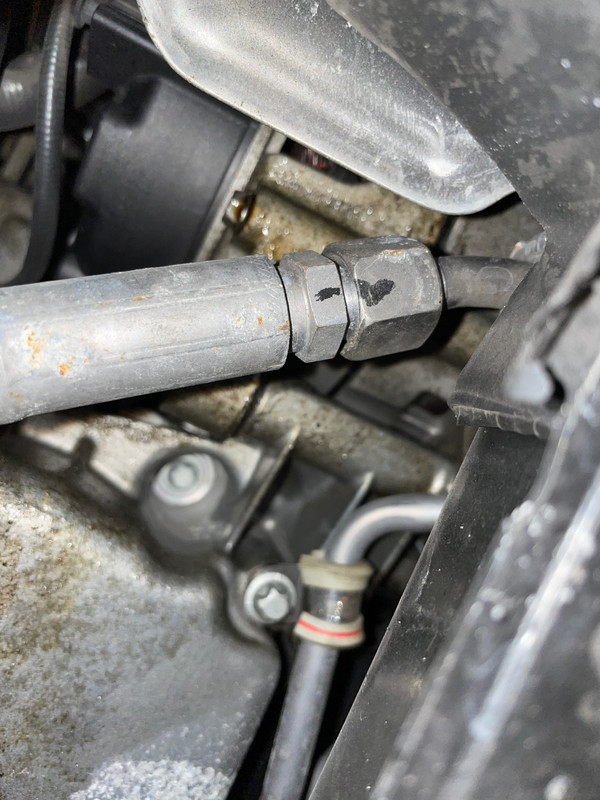

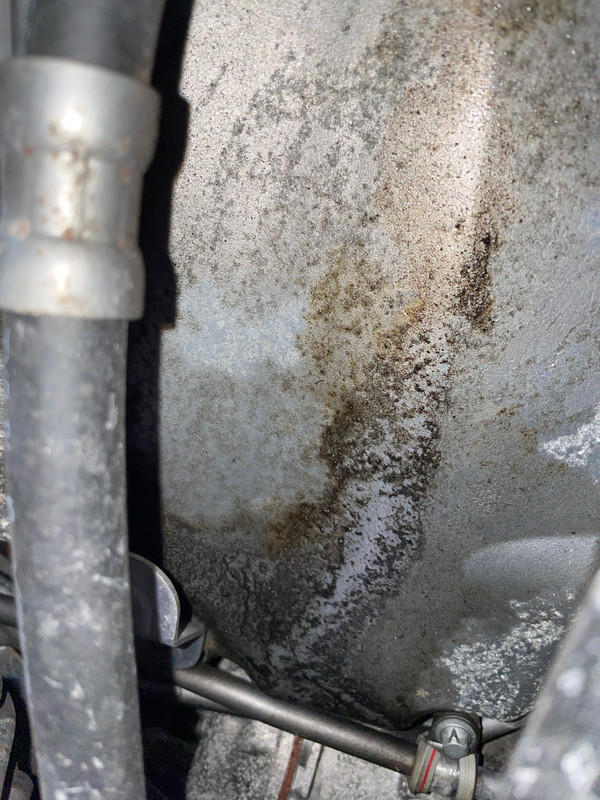

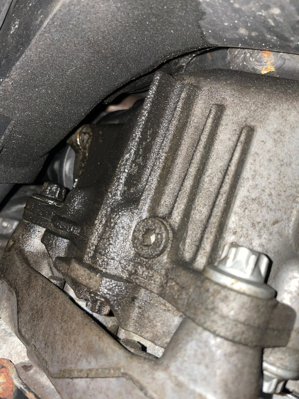

I found oil leaking on the back of the front differential, I believe one of the oil return lines for the turbo, and down the passenger side front of the engine onto the alternator. The engine bay is so packed I can't see were it is coming from.

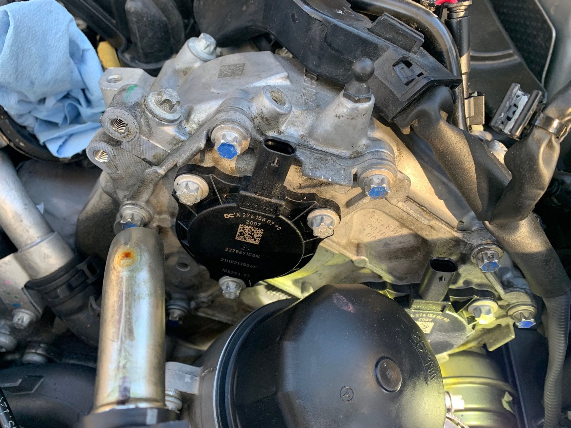

I had the same exact leak and my mechanic said on how it was coming from the chain covers So I just had them done. Hopefully that was it...below is a pic of mine.

none of those pictures get a l litre leak in a month - they are such light weeps you couldn't measure that on the dips stick in 10k miles
