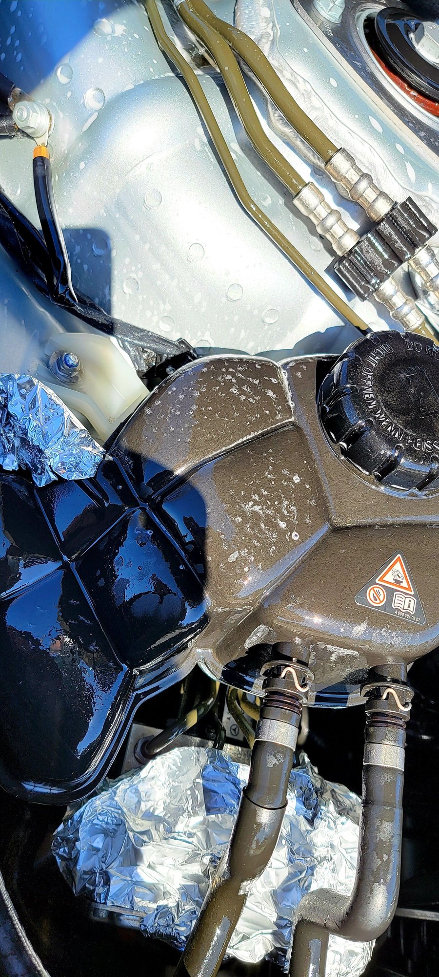

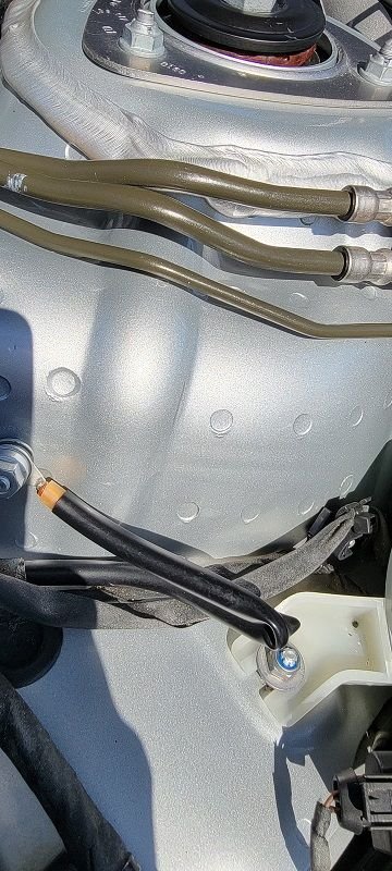

I've read horror stories about using a house/pressure washer on the engine bay. I didn't use my pressure washer but I did use my hose. I haven't driven the car in several day and the engine was cold so I covered every electrical connector with aluminum foil (shown in the first 2 pics), sprayed Gunk cleaner everywhere and let it sit for 10 minutes and then liberally sprayed the entire engine bay with a low/medium setting with the garden hose. I let it air dry and then wiped it down with microfiber towels. It sat for the day and started right up with no issues. With every electrical connector covered and not sprayed directly, I wasn't worried at all.

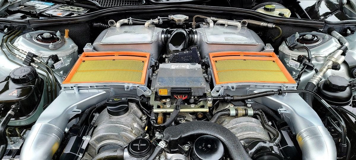

Good work but that looks just a tad too shiny. You sure it does not collect any dust? Because that looks like a dust magnet. Below is my S500 engine bay using Chemical Guys products. It comes out very clean and it has a factory
satin finish which does not attract any dust.

That was literally right after just spraying it before it dried lol. It looks like tire shine until it dries.
