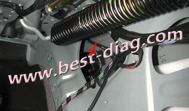

You can gain access to wiring by removing trunk panel.

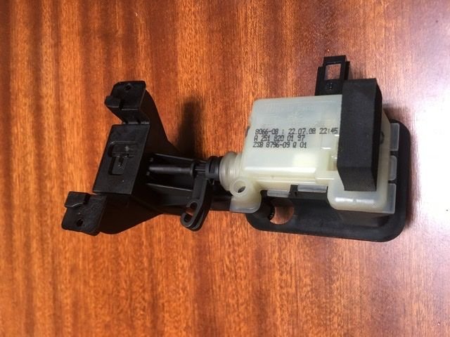

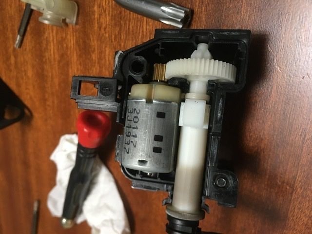

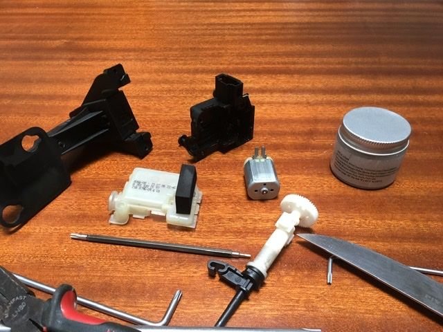

Access fuel filler door lock actuator from trunk then you can able to access emergency handle to open fuel door but will not able to remove actuator out for repair and replacement. For actuator removal we need to remove from fuel door filler as procedure i share earlier.
attached a few photo of the actuator for detail.
