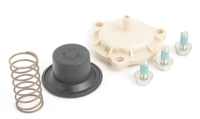

Are you talking diverter valve. If so, there is a repair kit available part # 2750960002.
