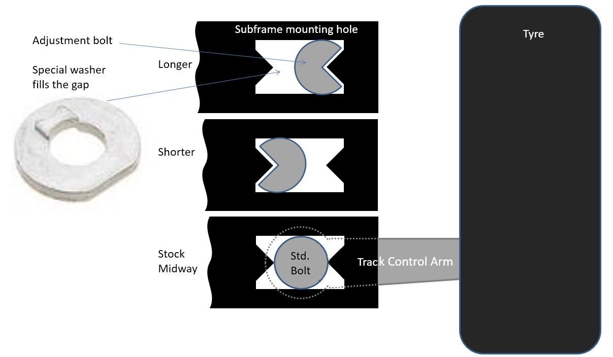

the bolt hole on the front subframe - inner end - where the lower track control arm is mounted on the car looks like the lower of these three pictures... the one with the dotted arm, now substitute either of the two (example) alternate mountings above it
so you lengthen (more neg camber) or shorten (reduce camber - head positive top of the wheel leaning outwards) the start point of where the arm bolts on the car
the Std big round bolt sits mid way held in that little star pattern (and delivers the settings you measured which must have been their aim on the right side of the car - as mine was like this 6 years before your car was even built).
ONLY to allow techs to notice this particular car had adjustment they use the strange weaker bolt and the funny washers to hold it in the new location...
But as we are only after a one time fix we don't need people playing ever again. So we can retain the bigger stronger round bolt and save a few pence - just remove the lugs on the subframe for the one time direction change we want to give the mounting bolt... and use just the funny washers to ensure the bolt never moves... When I bought mine from an old world once best in UK Merc dealership they explained they ONLY do what I propose here and NEVER use the silly bolts..... indeed they had the washers in stock.
NOTE doing so will send tracking way off - and will need to be fixed
I replaced the lower load bearing control arms on my car and did not observe any kind of a hole you show in your post. You mean it is the forward lower control arms?
