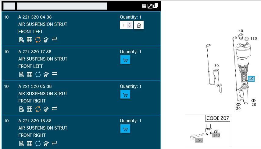

OE part #s to shop:

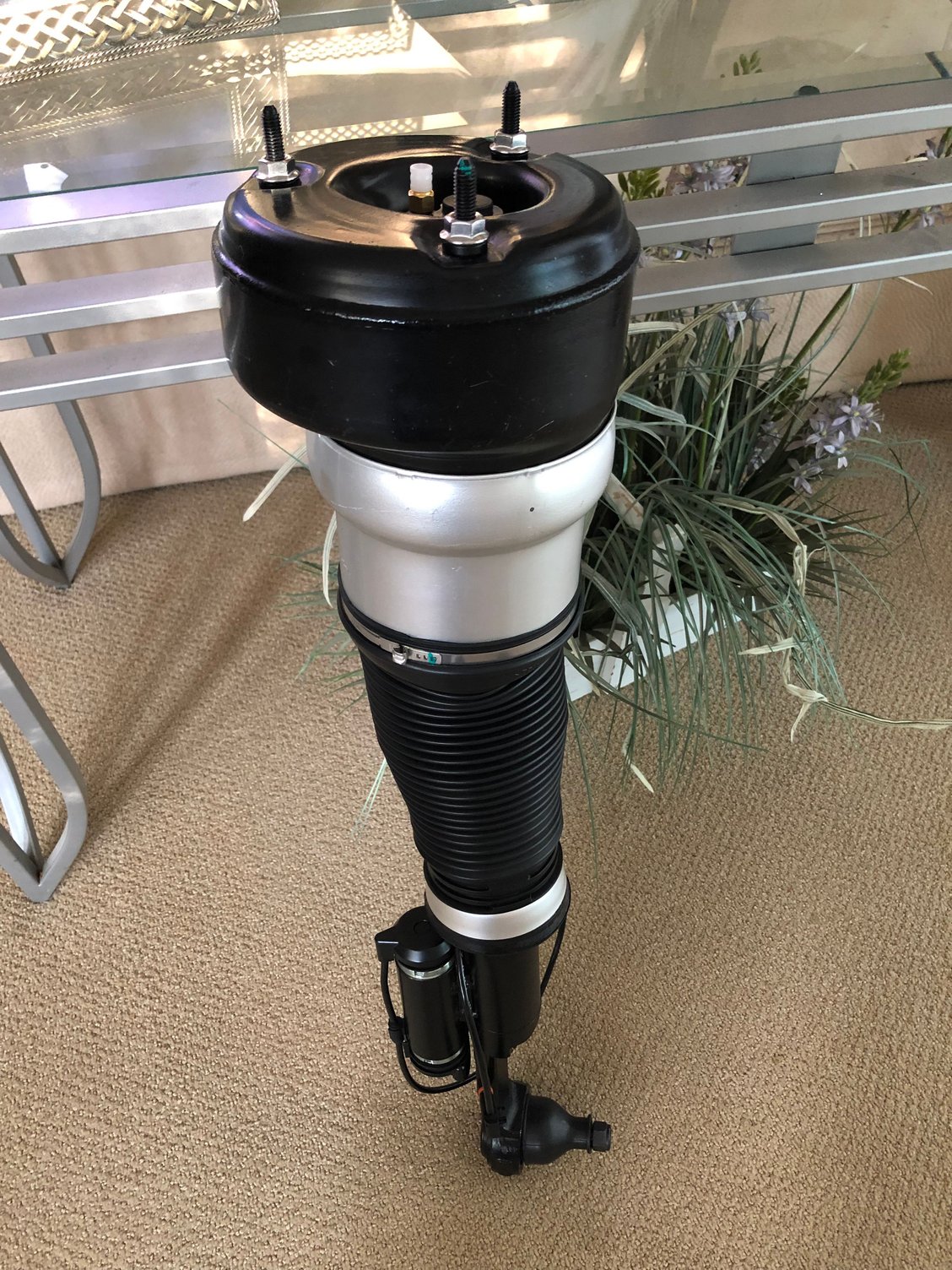

Hello all! If you don’t mind take a look at the pictures. I am interested in the strut but have a concern with the bellow or boot cover of the strut. It appears at the bottom the boot is lifted a bit or is not tight around the strut in that area...

Old Jul 28, 2021 | 07:10 PM
doni01's Avatar
iTrader: (1)
Joined: May 2015
Posts: 656
Likes: 143
2013 S550 4MATIC
https://www.ebay.com/itm/2009-14-MER...-127632-2357-0
I wouldn't buy shocks off ebay!! Buy from a reputable seller and a reputable brand. Unless you like doing the job more then once.
