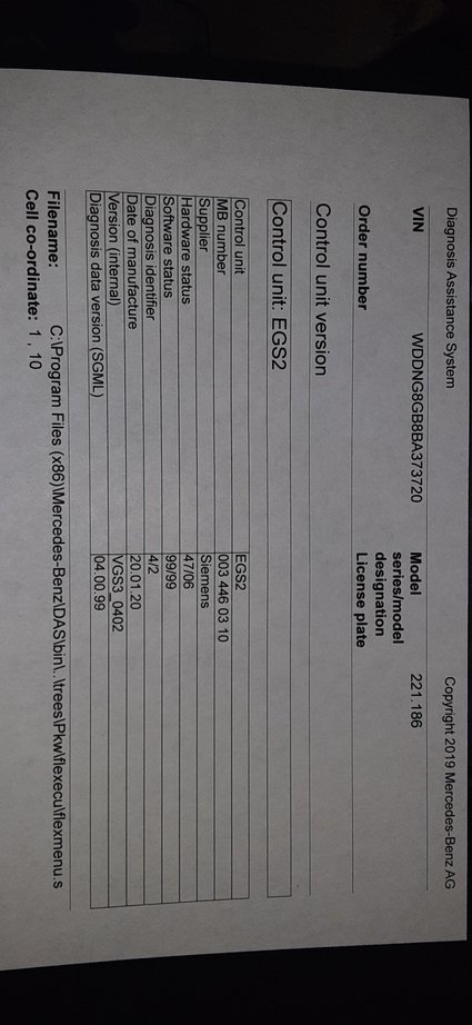

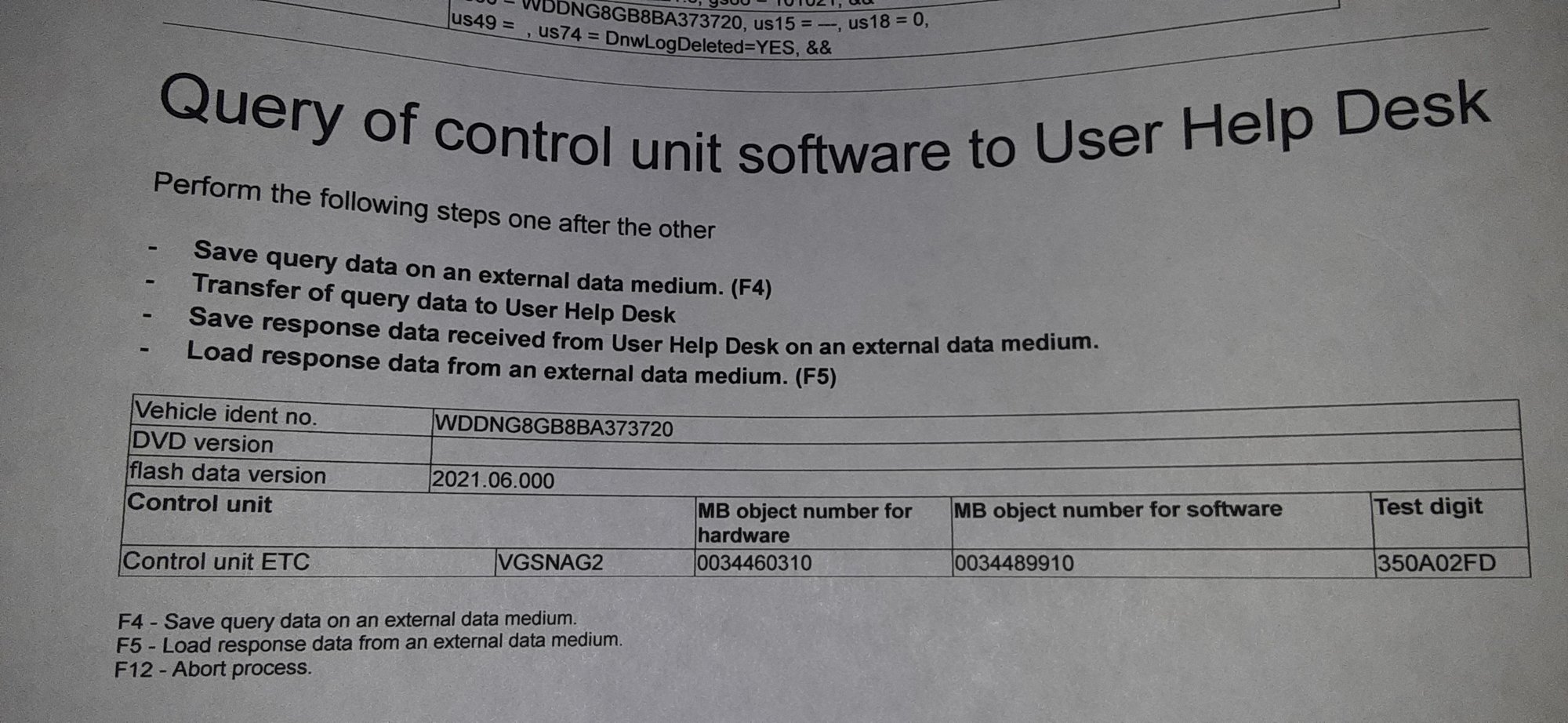

Ok..thanks sou like they trying to get me to spend big money.. called another Mercedes dealer and they said they can do it....🤔smh.....I do have a xentry c6 and my xentry gave me a file to query to the help desk to be uncoded and then be uploaded to the plate...but I couldn't query the file to the help desk on my computer..not sure why...but it also gave me this form it printed when it gave me the file with Info..
